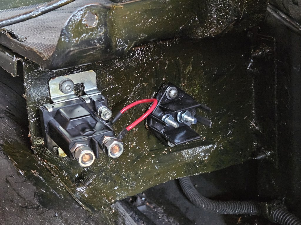

So, I have felt along the wire going to the block and I detect no deviations in the wire. It may be further back in the loom.
Today, I finally decided where to locate the aux dist block and charging relay.
I did not want to drill holes in the inner fender which limited my options. There seemed to be plenty of space on the side of the battery tray so that's where they went.
I'm liking that nutsert tool.
