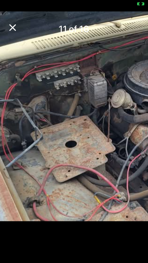

Where can I find this battery tray?

I saw a photo online of this K5 Blazer battery tray and would like to source one for my ‘83 K5 to use as a place to mount additional relays, fuses, terminals for electrical accessories. It may have been installed on military versions of the Blazers and would like to know if anyone knows where I might get one. So far, I haven’t been able to find one that mounts in that location. Or, if anyone has fabricated something similar, please provide photos. Any info would be appreciated. Thanks, everyone!

eBay/used is going to likely be your best bet.
Here is one on ebay
And yes, used on CUCV’s, M10xx trucks.

Another option - My ‘75 Camper Special has a factory auxiliary battery tray on the driver’s side in the engine compartment. IIRC, it’s the same tray as the main battery, but the support under it is a little different.
Camper Special wiring included a relay that allowed the alternator to charge the aux battery when the engine was running, but isolated the battery (to power the camper) when the ignition was off.
