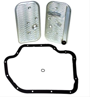

You are checking the fluid level with the engine running, with the shifter in park?
Drop the transmission pan. If the trans is cooked, that’s where you will find the debris.
Use 2 o-rings on the trans filter pickup tube. If your current tube has only one, use the old o ring off the original modulator. They are the same o ring.
Use a filter that has the brass screen filtering media. The cloth type filters being made now are entirely to restrictive. They can cause the trans to whine, especially when cold. Napa has the correct filter, it’s sometimes called the Allison filter.
If that doesn’t fix it, it’s probably worn out.

Thanks guys. Maybe I’ll try dropping the pan again and installing the Allison filter and double up the o ring first.
