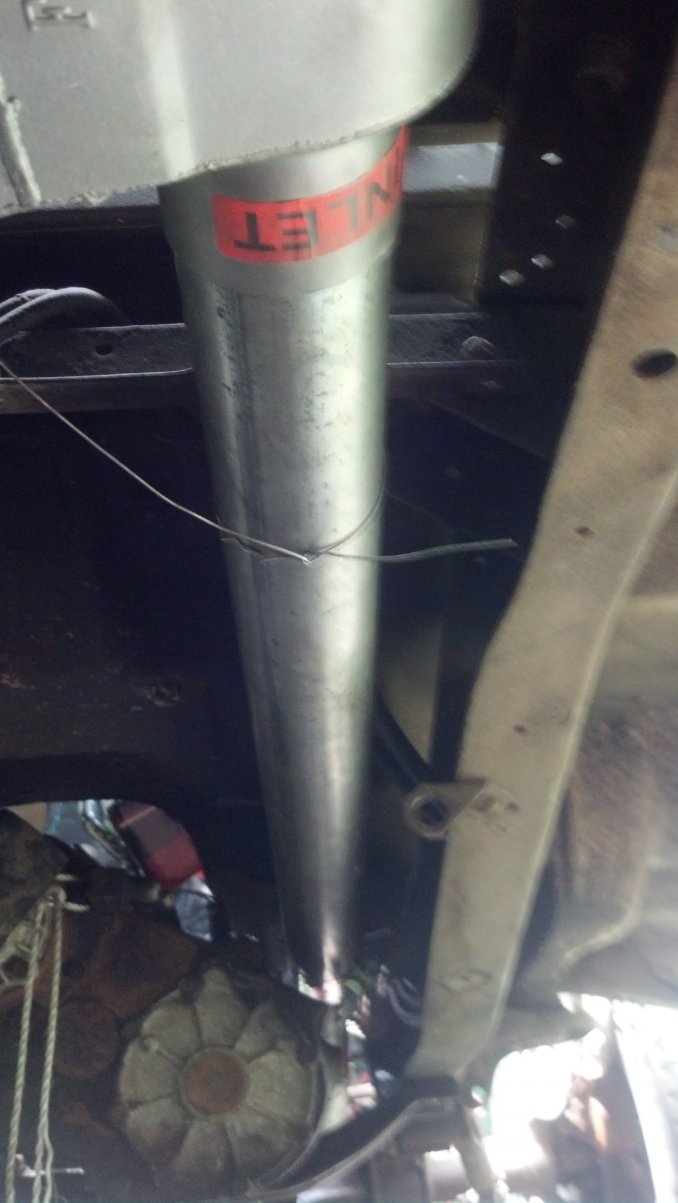

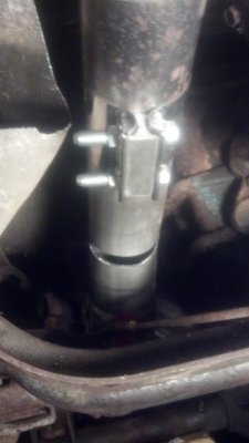

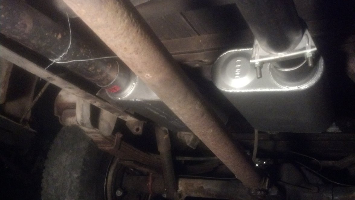

my cheap exhaust that sounds great
i have a 83 chevy c10 that i converted to a 4wd and made up my own 3 inch exhaust with flowmaster 40's i used long tube headers and went to napa auto parts since they sell exhaust pipe in 10 foot lengths so i picked that up and 4 3 inch 45 degree elbows and made up my own true dual exhaust im very happy how it turned out wasnt to hard or expensive i think it ran me like 85 bucks for the 10 foot piece of pipe and 4 elbows i mig welded all joints but 2 joints i used napas band clamps for simple removal of exhaust so it can be worked on or changed had to cut and open the angle of one of the 45 degree elbows then i welded it up to make the two mufflers evenly tucked up between the frame rails
