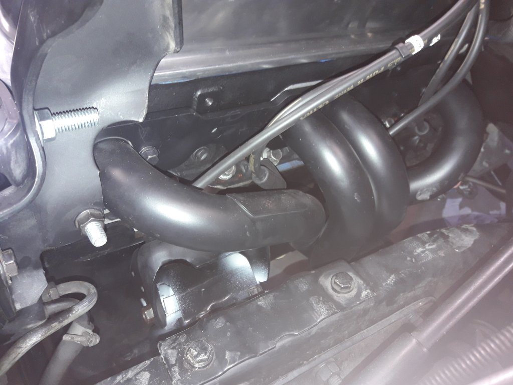

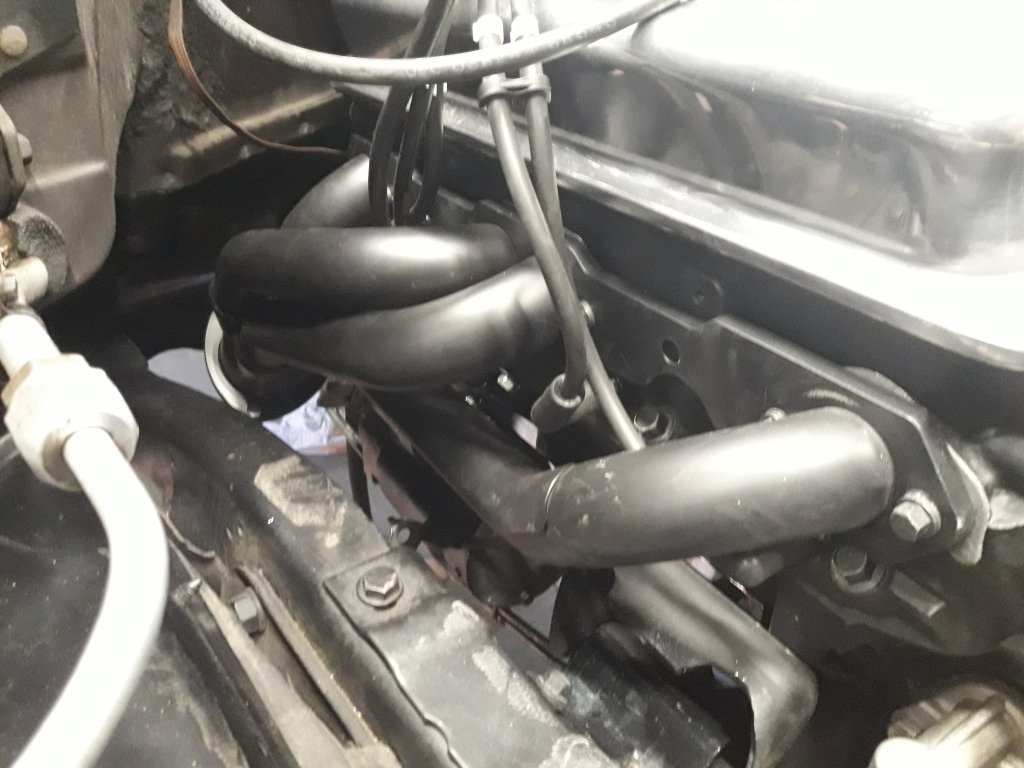

Anybody with a K10 running Shorty headers? just curious what style and brand would work for my truck. 350
We used Hedman Standard Duty Black MAXX Ceramic-Metallic Coated Mid-Length Headers on a SBC 355 with Vortec Heads. Collector connections are kept high as we did not want the exhaust to hang low.
