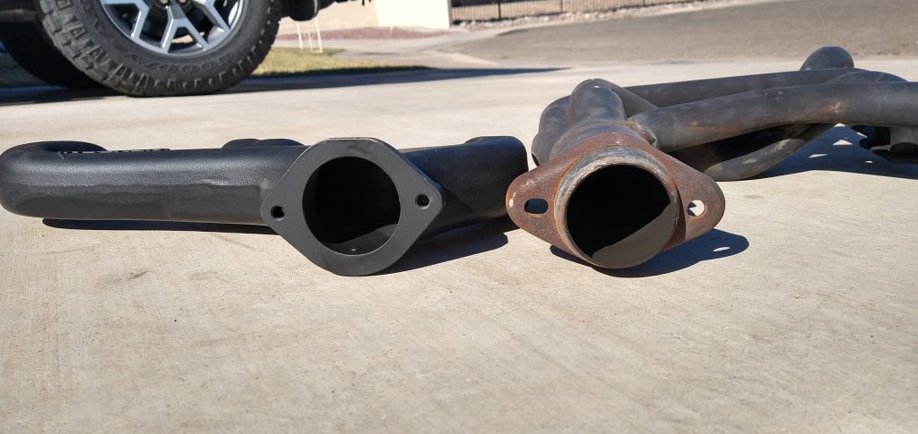

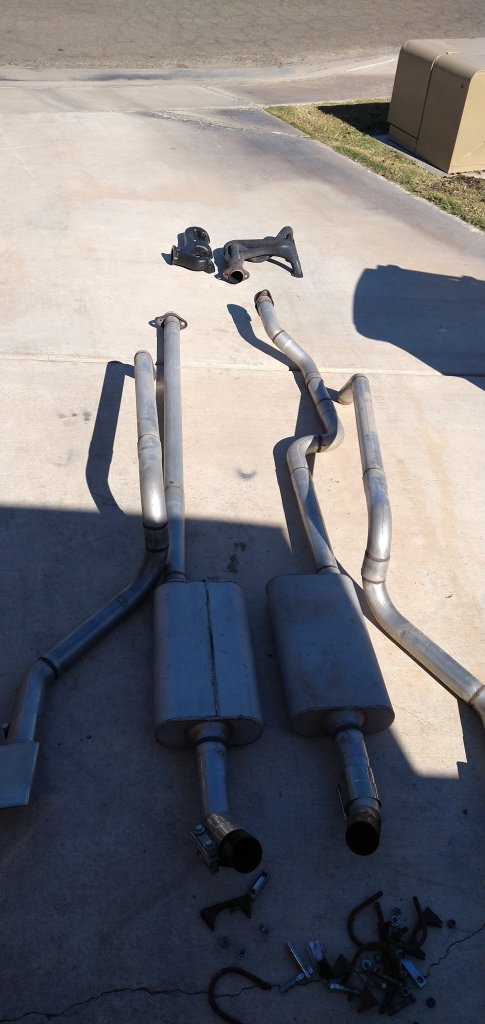

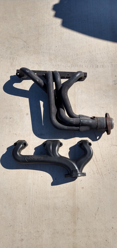

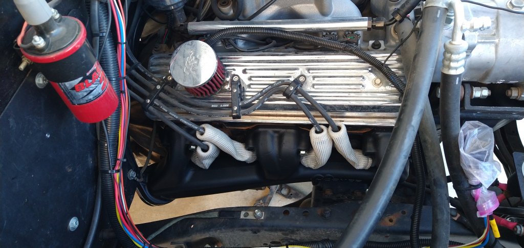

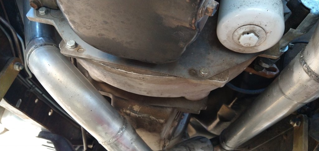

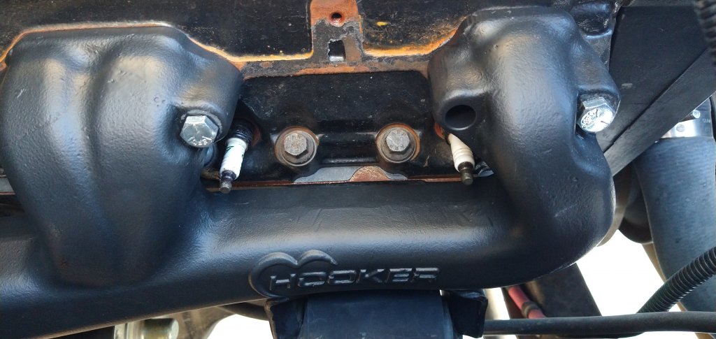

Removed my 2.5 dual exhaust today. Exhilarating! Mounted the new Hooker manifolds and immediately felt this was one of the best mods I've ever done to a vehicle. These things are bad-a_s_s.
1. No more "special" tools to remove sparkplugs.
2. No more burnt plug boots
3. No more dropping the PS header to remove the starter.
4. Lower under-hood temps
5. No more rusted out header tubes.
6. No more leaking gaskets
Soo much room around the engine block and clutch linkage.
On this SBC I'm 99.9% confident there is no loss in performance for a daily driver. Check out the pic of the collector outlets.
The manifolds actually get larger from front to rear and curve slightly to create the perfect exit angle.
Tommorow, I'll continue fab work on the 2.5" Y-pipe. So far I'm super happy with the manifolds.

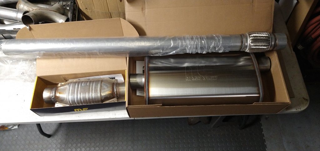

Going with Magnaflow this time. That includes 3" cat, flex joint, muffler (very impressed with the quality) and 3" tubing out the DS rear.

Is this a stock SBC, and which manifolds did you use? Hooker shows two parts number 8525 and 8527, and it seems like the 8525 has the standard rectangular port for an SBC head. However, the text says it’s for engine swaps, so that confuses me.

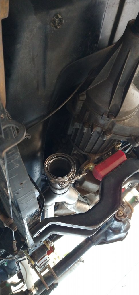

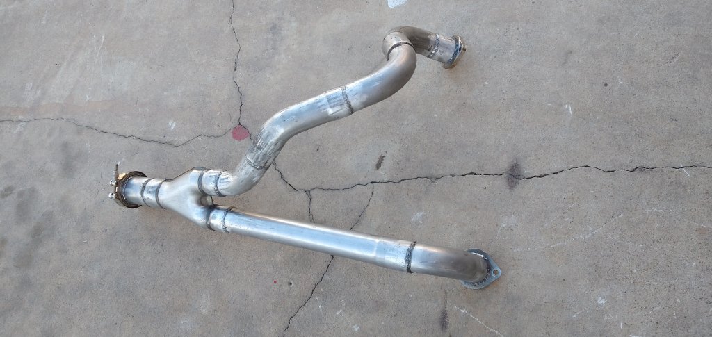

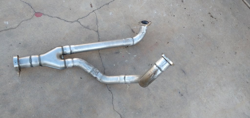

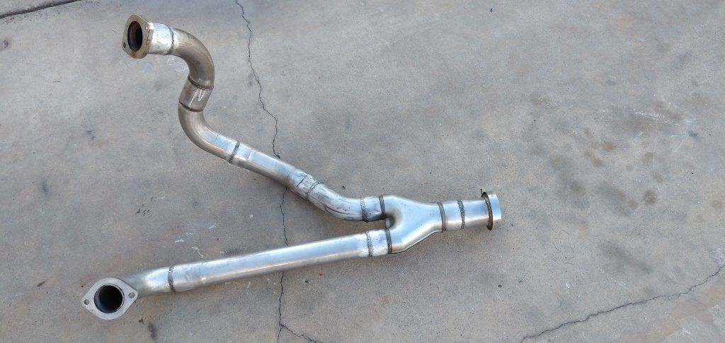

Y-pipe is done except for the Oxygen Sensor bung. It's tight under a K series using 2.5" tubing but where there a will there's a way.

Are you still going to be able to put the o2 bung after the y, or did it end up being too far downstream?
I can’t remember the instructions verbatim, but I thought it was supposed to be within 12” of header collector.
SquareRoot
Mar 18, 2017
4,394
8,558
Arizona
85
It's in the 4 inch section I added after the merge collector. I didn't have a weld in bung on hand so I'm waiting on that.
