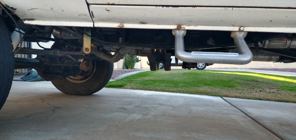

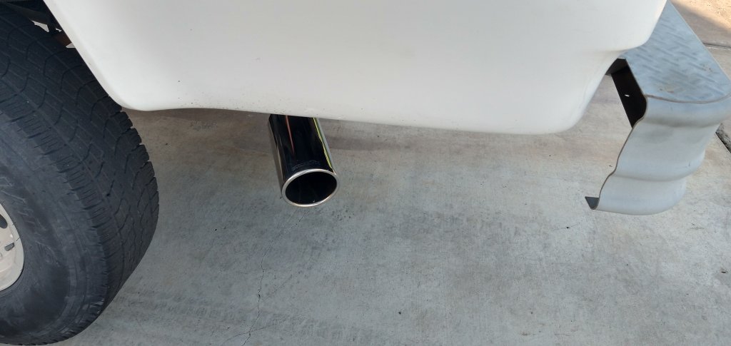

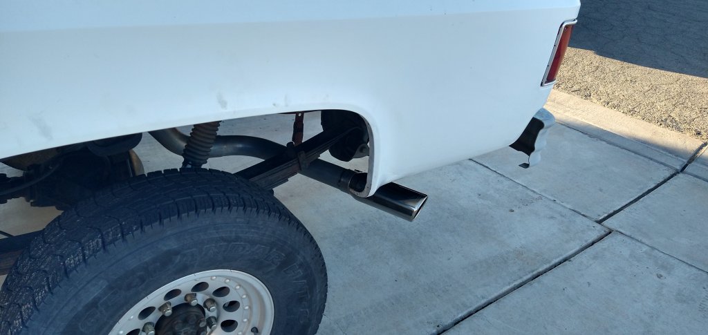

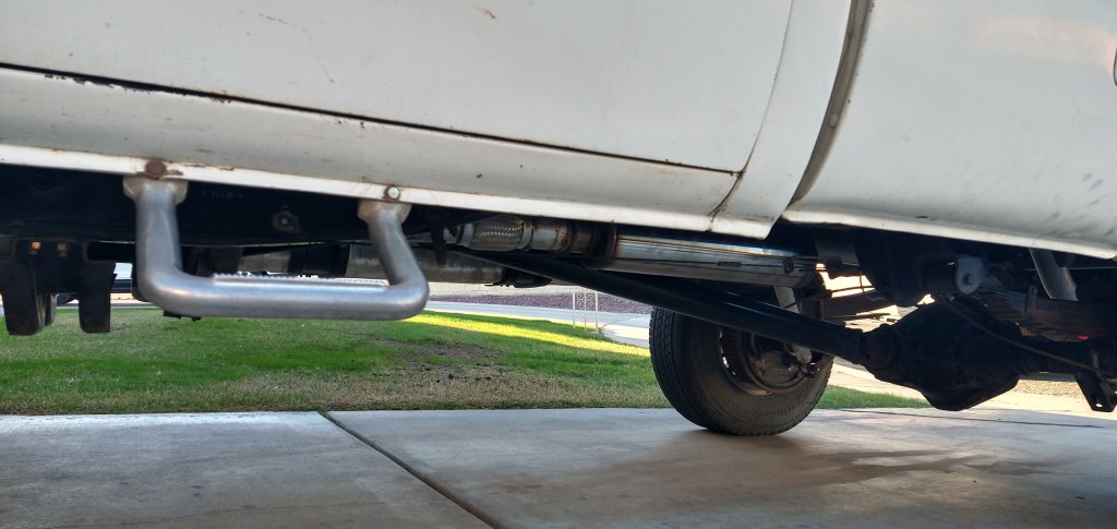

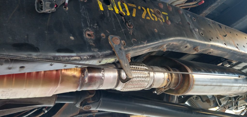

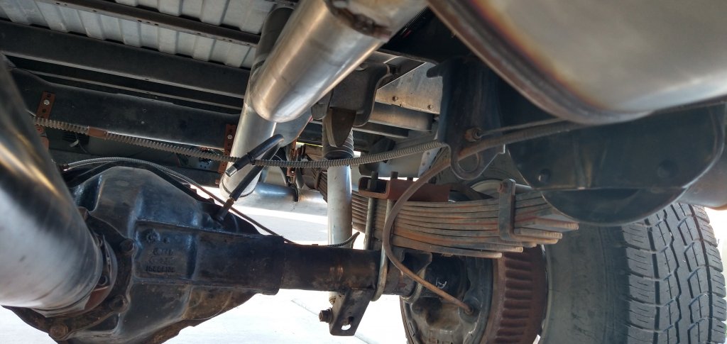

Damn! Got a pinhole leak in the y-pipe. And if course it's in a spot I can't get to from below. Gonna think on that for a few days. Otherwise, sounds good. Got all the new smell almost gone that comes with new tubing and a new cat. Not sure how to upload or link this video or mp3 file?

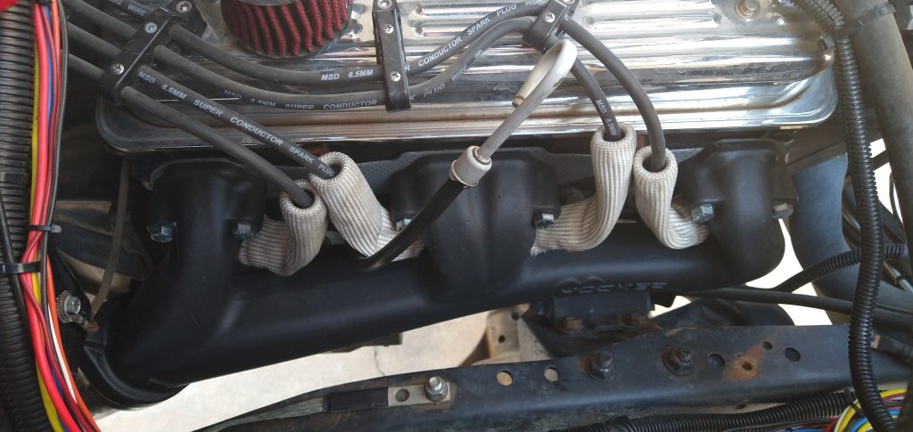

Forgot the best pic. I call this "just the tip", lol.

So how the hell y'all keep the manifold bolts from loosening up after heat cycling? Retorqed them three times already. I used a "little" copper anti-sieze on them as suggested. I'm considering going with the Stage 8 locking doo hickies?
