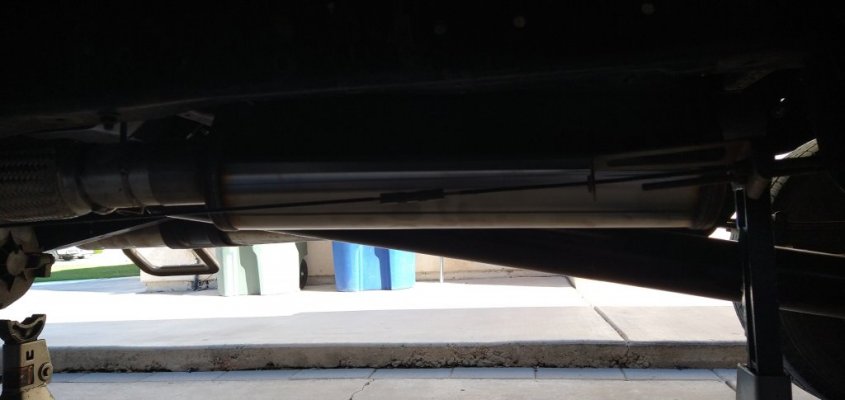

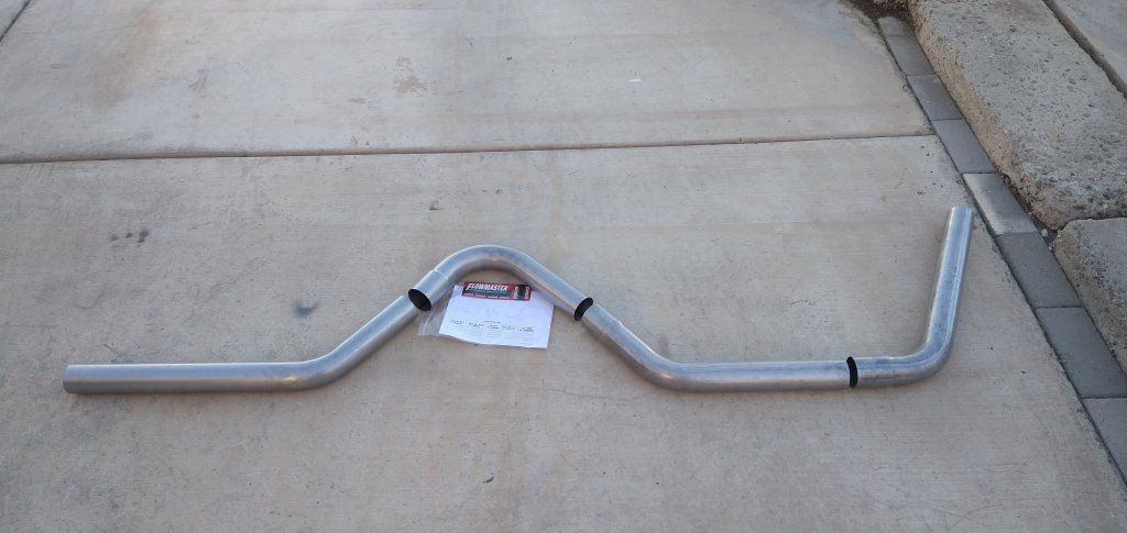

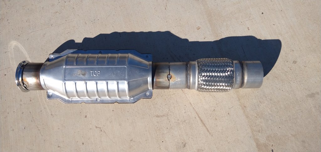

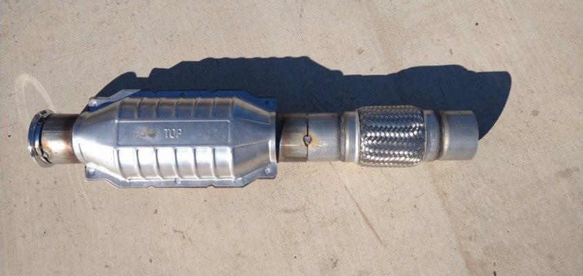

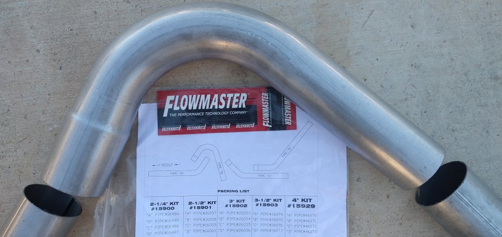

Found box #2 at my front gate this morning. The last piece of the puzzle. Flowmaster universal tailpipe kit for trucks. Single, 3" mandrel bent, slip-joint kit from Summit. Like $139. No brainer. Fit it, cut it, weld it, done!

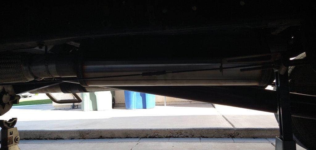

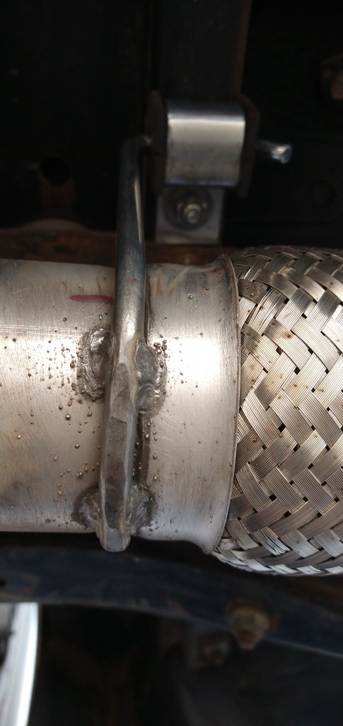

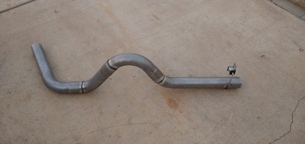

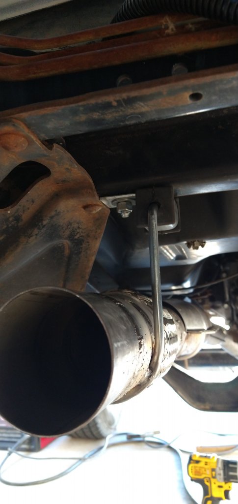

Going together like a dream! Got the whole thing mocked up today. Lots of cutting the tailpipe pieces in the kit to get the angle's just right. That kit is awesome. They give you wayyyy more length on each piece than you need. Bending the hanger was a PITA but I got it done. I wanted a modern factory look which requires bending the rod to a 3 inch radius.
The entire exhaust is above the frame rail. You can't see any of it except the tailpipe exit. Lots of room, I love it. Hopefully finish it up tommorow.

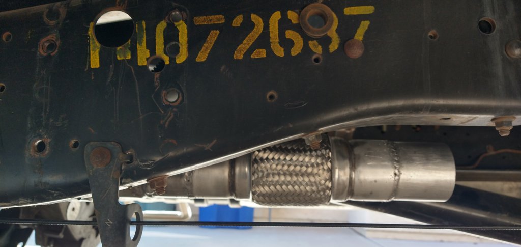

Guys in Arizona don’t know how lucky they are, look at how clean the underside of that truck is!!! I would bet there is not a single bolt that couldn’t be remove without twisting off or rounding the head. Northeast guys and gal’s would find it sooo easy working on a desert square. Not that that is an issue probably more wishing my square was so clean.
Just wanted to show you this pic I took today while under the truck. That's the original GM VIN from the factory. Pretty amazing after 37 years.

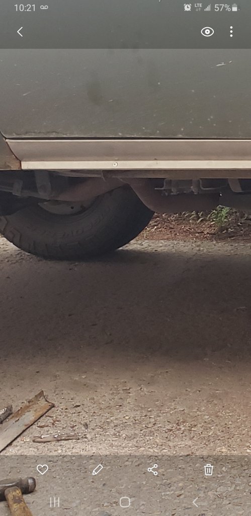

I think I might order up a set of these aswell before I go and do my y pipe. You did a awesome job on yours. Are you able get a few shots of how close you were able to tuck it up mine hangs down lower then the transfer case and drive me absolutely bonkers. I got one on my phone right now on how badly it hangs down.

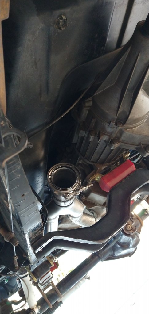

My crossover pipe runs diagonally across the bottom of my transmission. It's an NV4500, a big mother! I left a 1/2" gap since the trans and pipes are all one unit basically. However, it's still above the cross member so it's protected and out of sight from any angle outside the truck.
