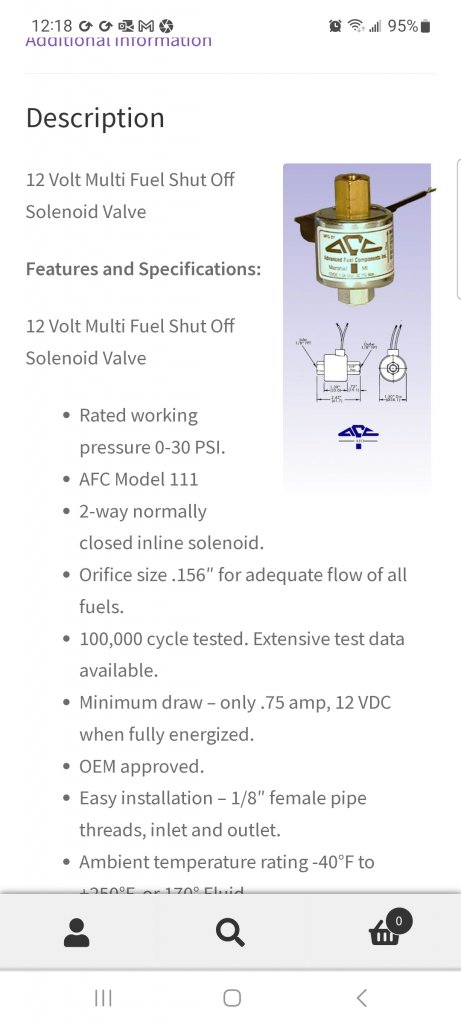

Fuel cut off solenoid works on anything.
Hmm, can you link what you're talking about that will work with these trucks? All I'm seeing the manual shutoff type.

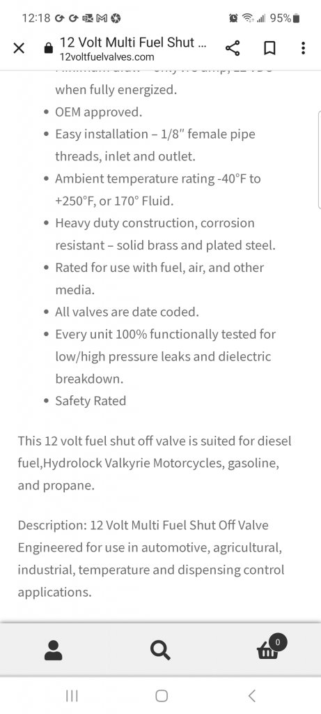

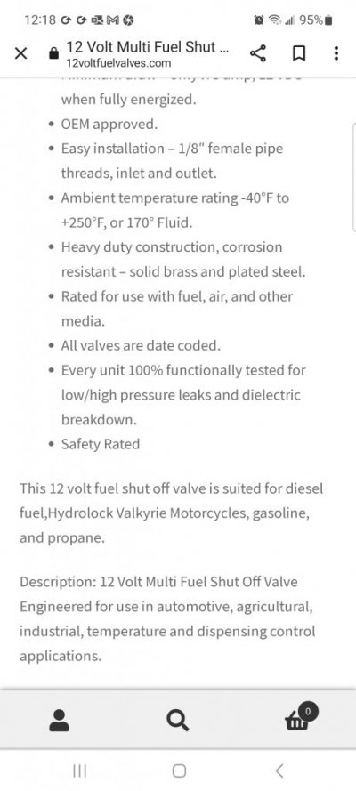

They are mainly for industrial applications fork lifts,tractors etc. Just Google search 12volt fuel cut-off solenoid,look for one that suits your needs.
