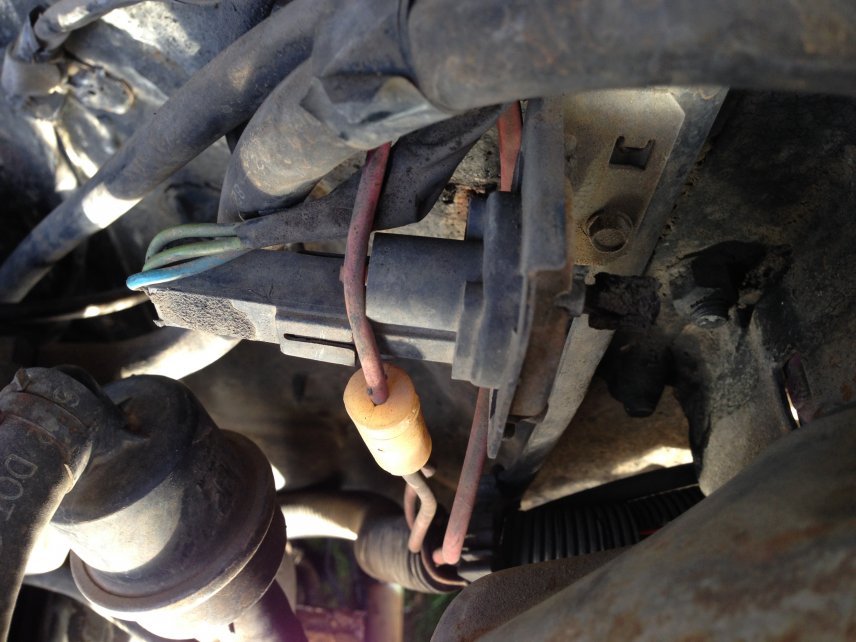

Another weird part

This is behind the left side of the power brake booster, has three wires (2 green,1 blue) on the left side and vacuum(?) hose coming out the right. I don't see where the hose would go to. Thanks....

cruise control?

That's the vacuum switch that controls torque converter lock-up. The hose is supposed to be hooked up to manifold vacuum.
