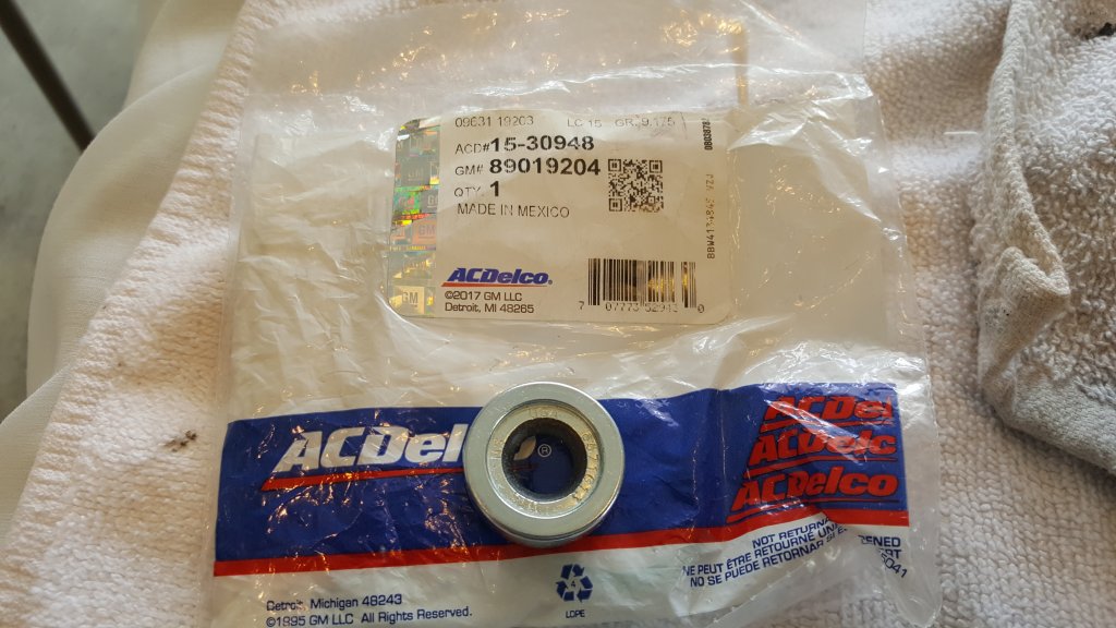

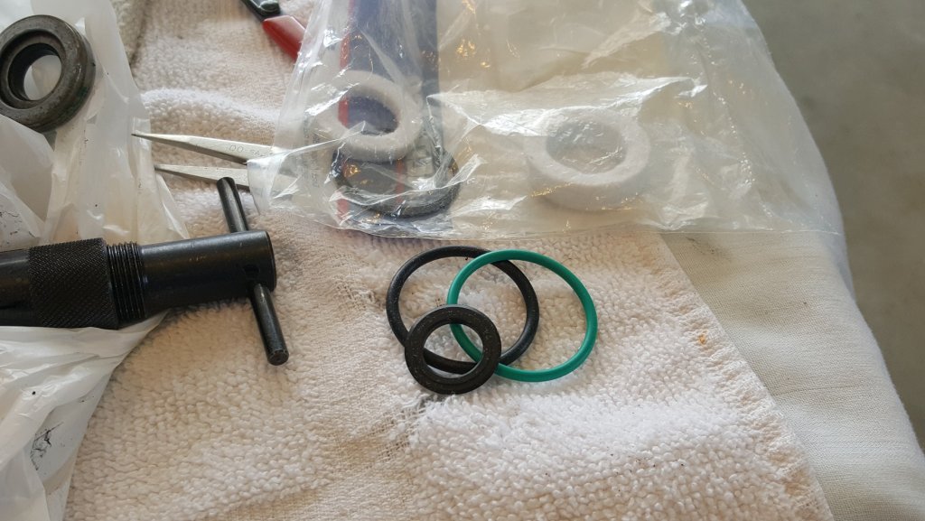

The A6 and R4 (which is still not a good compressor) can both be retrofitted (you pull out the 'bird cage', if it has a ceramic seal) to the newer, double lip seal. Only way I have seen them not sling oil. I've done quite a few.
The same seal also fits the V5 compressor, which didn't get this seal in production until around '99, even though FSM's say otherwise.
OOO my V5 is 99 model year, probably built in 98. my 99 aurora probably has a V5 too same situation
Case corrosion makes the V5s leak at the body o-rings too. They didn't have such and issue with this when painted.
