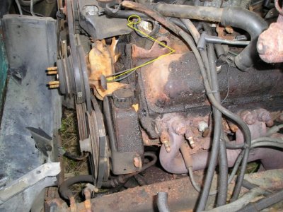

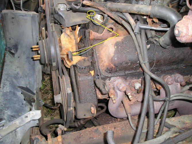

If the compressor clutch doesn't pull in with the low pressure switch jumped, check the ground wire and bolt:
