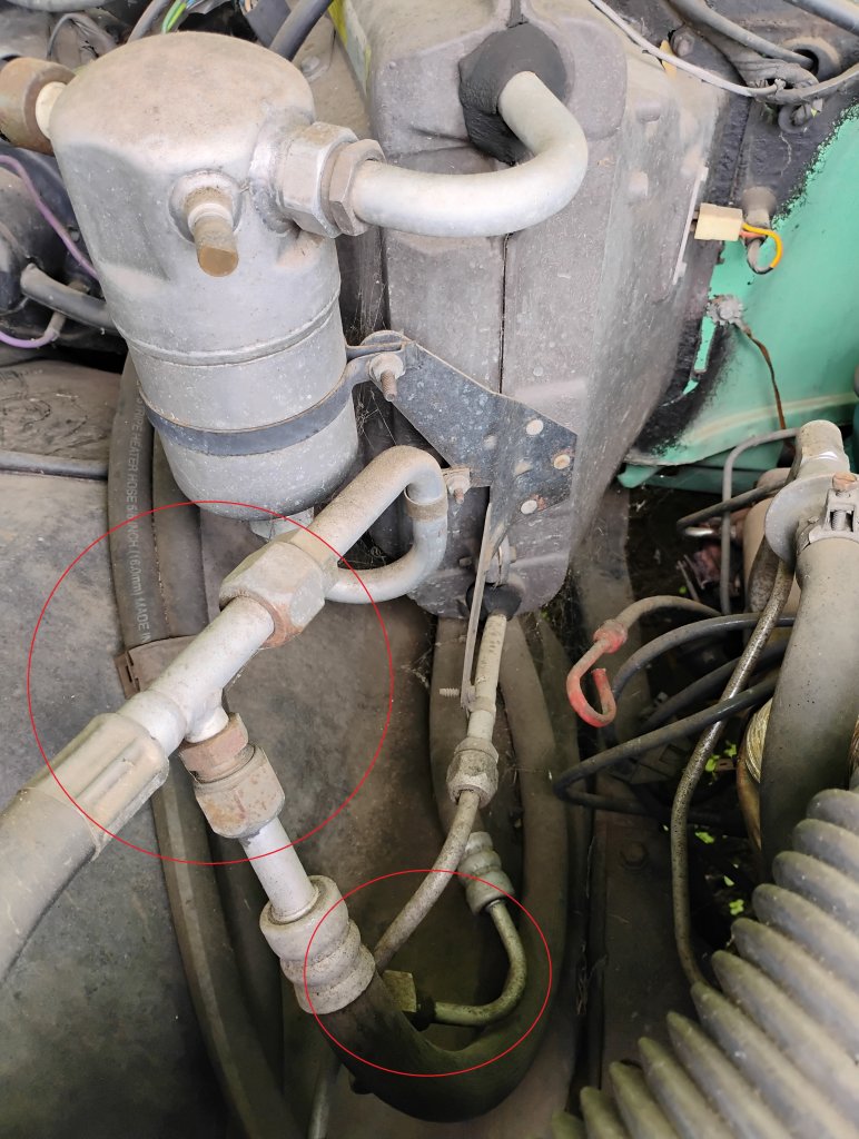

Yeah, it's quite overwhelming at first, with so many fittings, the different sizes, the rear evaporator and such. Hopefully helpful for anyone brave enough to tackle the job! Heck, just a couple weeks ago I didn't know a TXV from an orifice tube, now I feel like I have a handle on it. The real test is when I vacuum it down, soon I should be ready to start evacuating and testing all my work.

All fittings and new hoses installed. It's been holding 26" of vacuum for over 3 hours, so I may be getting close to charge time. I don't have a nitrogen tank to pressure test, but it does hold vacuum. Added a total of 11 ounces of PAG 100 oil to the system with 5.1 oz in the new compressor., the rest distributed to both evaporators, (1.5 oz each) condenser (1 oz) and accumulator (2 oz).
Needle hasn't moved since first pull down.
I have 6 cans of r134a ready to go in. My only concern at this point is if the Sanden SD710B/7176 will have enough capacity to chill both evaporators when idling. Time will tell, hoping the new condenser will balance it all out.
Rear lines with new barrier hose installed.
Close up
