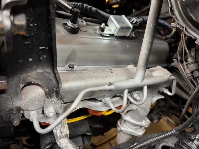

I got ACCEL 4048 Spark Plug Wires I thought fit my 83 K20 Suburban 350 LT9 (wires route underneath the exhaust manifold), but no matter how I route the wires a couple of the wires are super short and too tight to the exhaust so expect they are wrong for my application. Frustrating as it runs great, but sure don't want to risk burn through. Does anybody know the correct ACCEL set number?

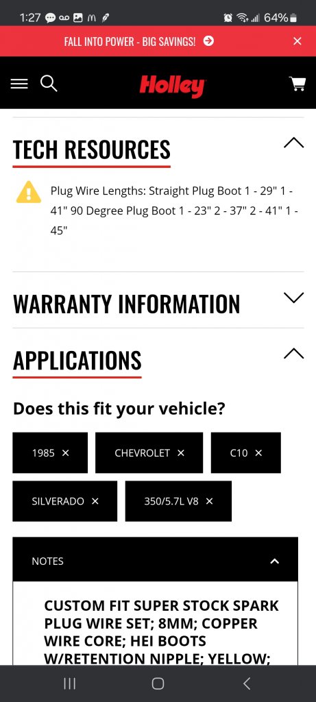

4048s are listed as an over the Valve Cover set. 4049 I got a screenshot of the wire lengths,if you have your old ones to measure. I think 4049s are what you are after.

@Ricko1966 thanks much! I'll guess I'll just get the 4049 set
