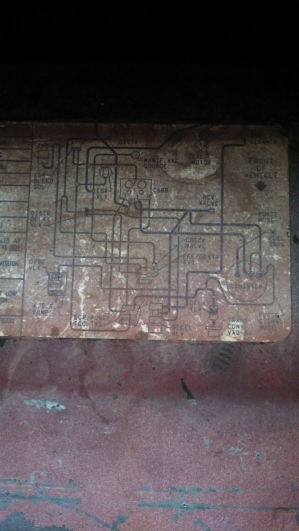

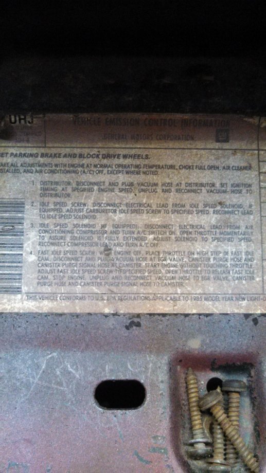

Can we get a good clear pic of your emissions label?

Sorry for taking so long guys, I've been busy with ya know life.

But honestly do those pictures help? They mean almost nothing to me..
