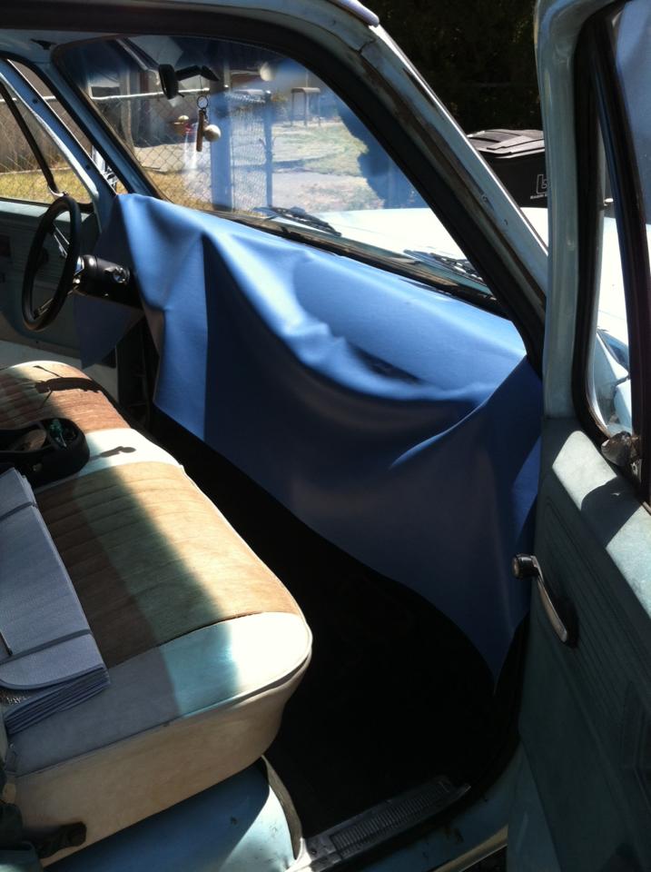

This picture is after I slid the cover over the dash. I wanted to be able to stretch the vinyl tight and I couldn't when it was sitting on the floor. I glued it down to all the flat horizontal areas here. I'm going to let it sit for a while before I start attacking the corners where I have to use the heat gun.

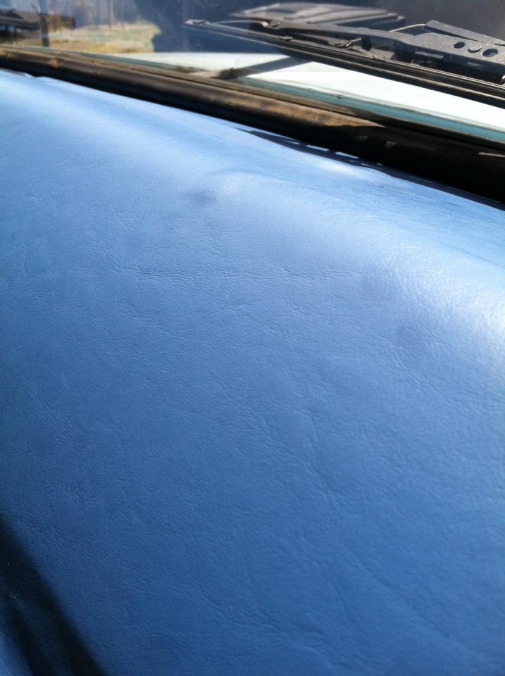

An air bubble. I'll take a small needle later on and get the air out. I've also noticed that every spot that had the new expanding foam exposed thru the bondo showed a little raising. It's too subtle to see in a picture. I have a dash protector pad coming which will hide all the little imperfections. The spot I was most worried about was the speaker hole that had all the bondo in it. You can't even tell where it is under the vinyl. I had to run my hand over the area to find it. If I were to repair a dash like this again I'd sand the foam down below the edge of the old vinyl so I could use a little more bondo and make sure no foam is exposed. I also learned that contact cement has to be applied very thin. It drys faster and holds a lot better than when more is applied. I had a hard time trying to get the vinyl to stick in the little corner that runs the length of the cover at the front nearest the windshield. I finally decided to glue it to the under side of the cover and slid the vinyl under the mounting clips to help it hold better. Once I installed it on the dash I realized you can't even see it so I'll just leave it.

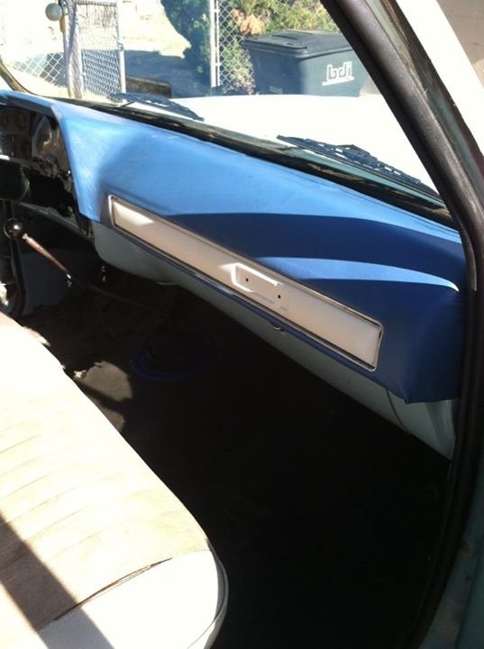

Finished the dash today. There were some minor mistakes but the new dash pad I have coming will cover them.

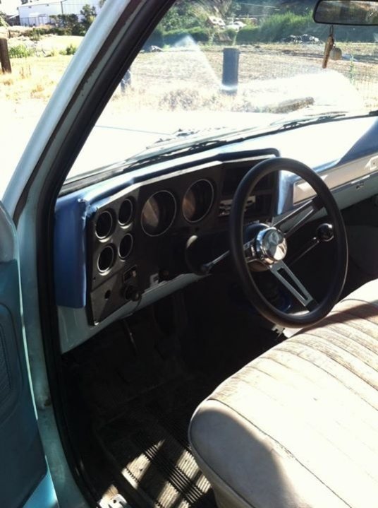

Another view
