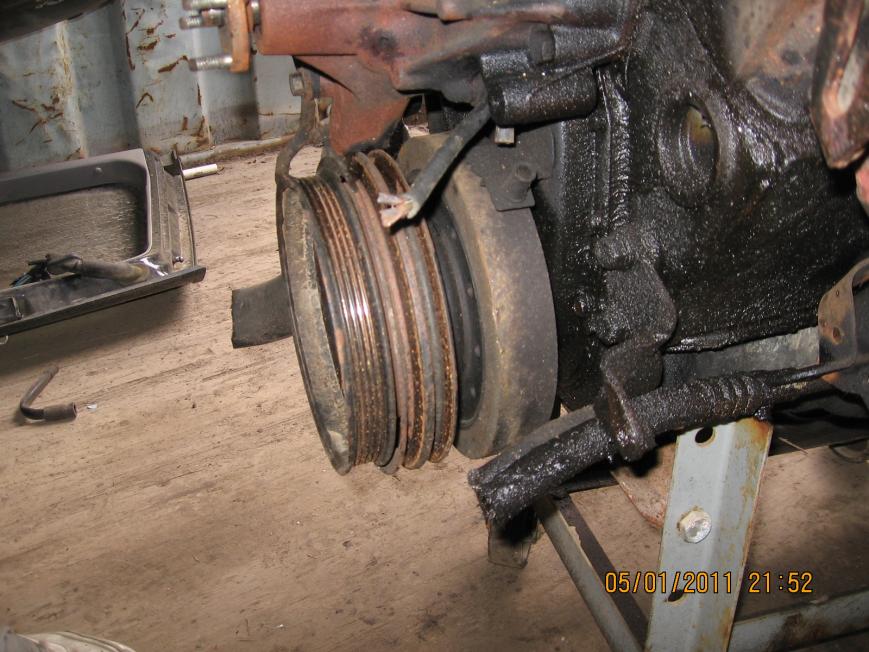

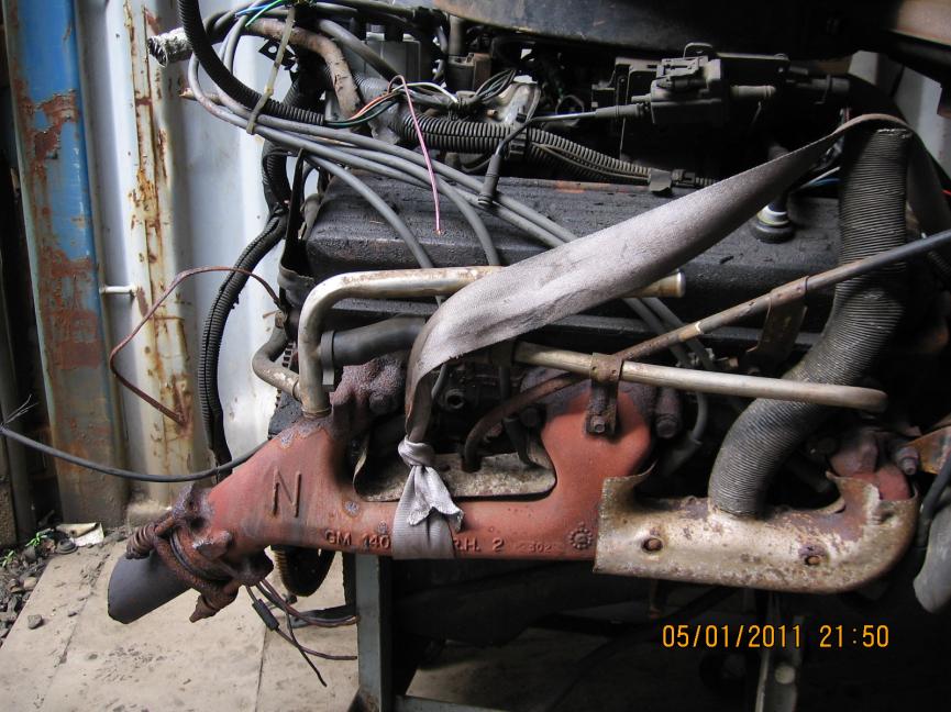

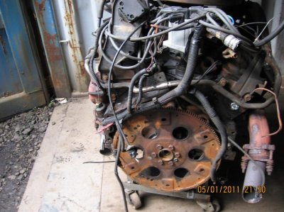

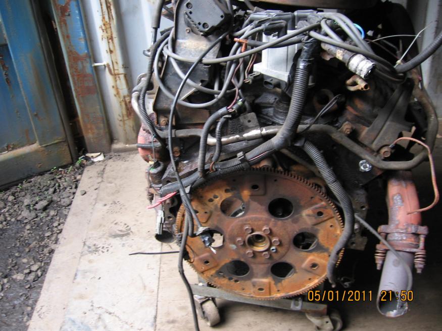

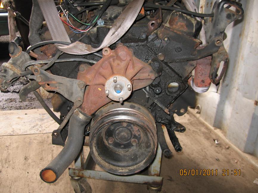

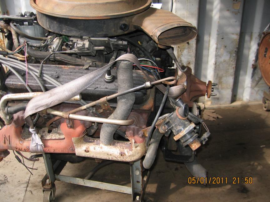

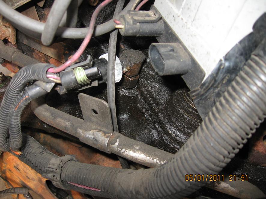

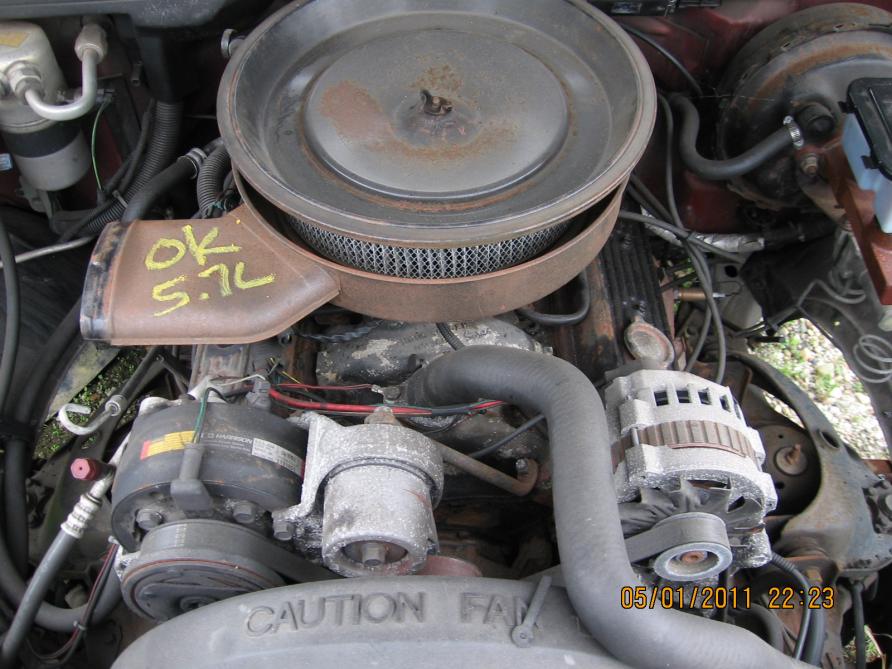

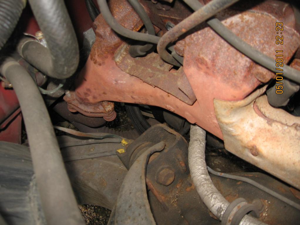

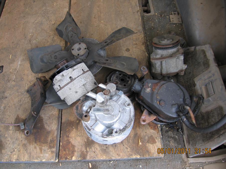

So this morning I left a little early to swing over to the U-Pull it to check the motor out and I jawdropped. Fukin thing was a major POS. I think it had more oil on the outside than the inside did. Had air injection, accesories and pulleys didn't match. Manifolds were rusted POS's. :flipthebird: :flipthebird:
No way this was going to be a drop in motor. :flipthebird:

I told them FORGET IT. :flipthebird:

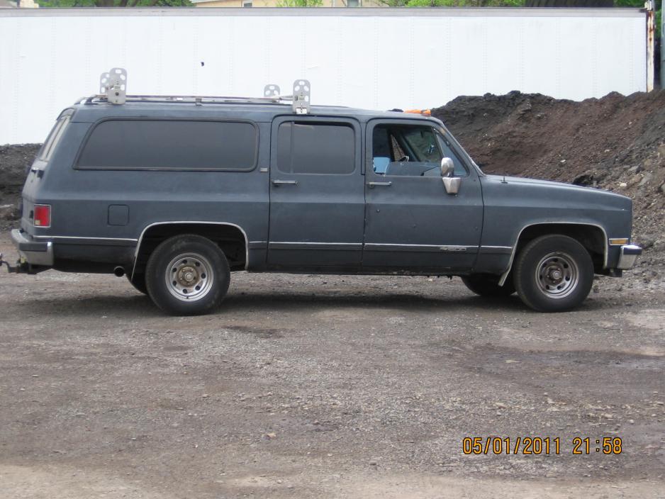

As I was leaving this pulled in and parked. :High 5:

i would consider that to be a core motor, would not be putting in anything i own with out a tear down, you were smart to walk away

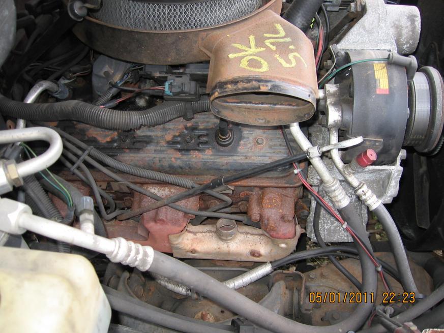

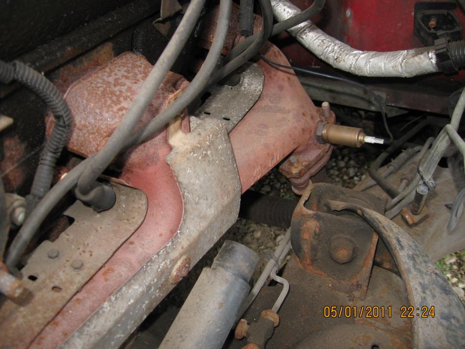

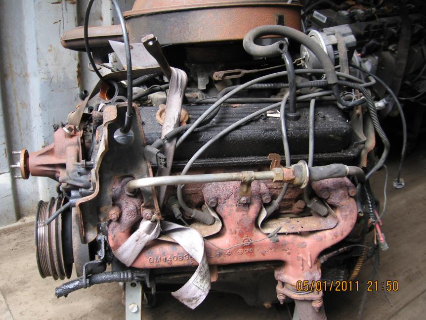

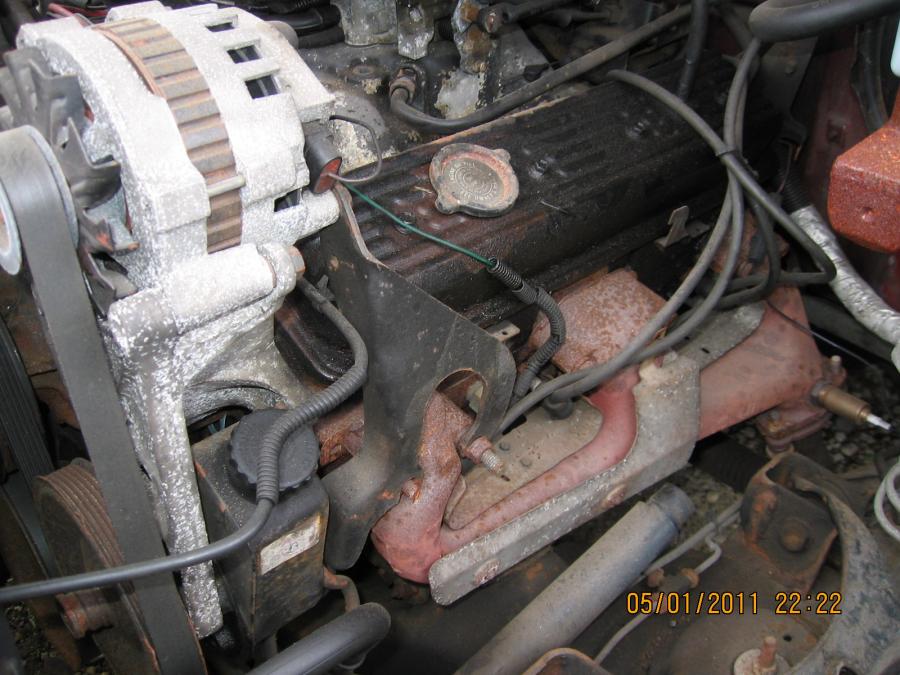

Well, I got all pissed off, and headed over to the scrap yard where I seen that Blazer for sale, remember that one I posted, the red and silver one? I was going to see if I could buy the motor out of that. I got there and they already sold the truck complete already.
So dude told me he had a 90' TBI motor still in a junked Chevy P/U that ran good, but had 180K on it. I checked it out and decided to but it. Only thing I see different is the cruise control, the exhaust manifolds are different, and it doesn't have the oil cooler diverter. He said it ran fine. Buying complete motor for $500. Picking up Saturday.
Here it is fellas:

Did you get warranty with it. If not it was little high at that price. IMO
28,638
10,051
Were you able to hear this one run?
