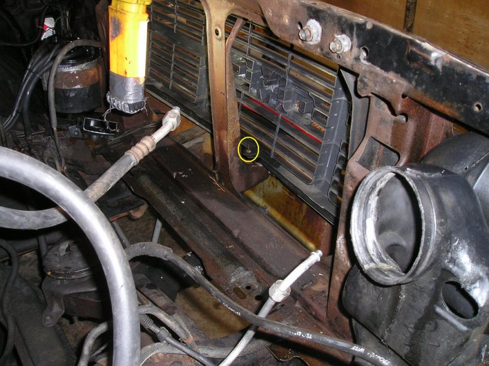

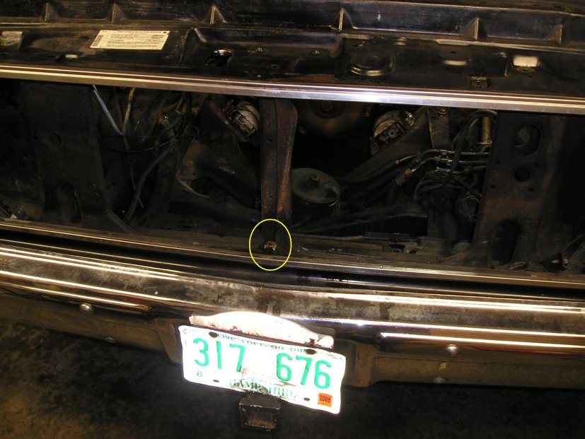

Per towjoe:
There is also a screw in the middle I believe comes in from the bottom of the grille
That's the one that always gets overlooked.
