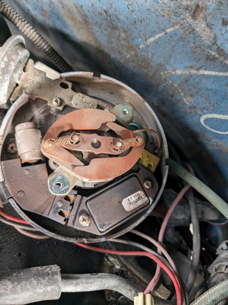

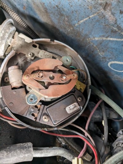

While trying to set base timing I noticed some odd behavior. Each time I tested it (before setting), I'd get something different (vac advance disconnected).
The an old Mallory 8548201 that they don't seem to acknowledge any more.
A look under the cap after (#%$^$^%U$T!!!!) removing it (not a fan of the 'wire hold-down' style cap in this case)
revealed the photo below: it's quite dirty and the weights are rusty. Pretty grainy feeling while trying to move them and they'll stick closed, stick wide open, and stick anywhere in-between.

Clean and lube weights make sure they will advance not stuck, check vacuum advance, inspect white and green wires close to pickup coil for wear [actually I give them a light tug] remove module and reapply silicone grease. They are very dependable units.
If centrifugal advance is stuck it is relatively easy to fix that too.

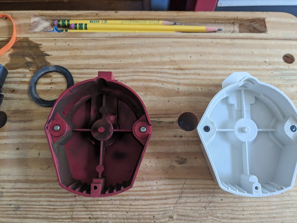

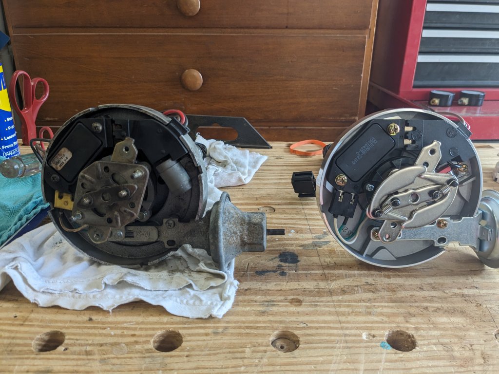

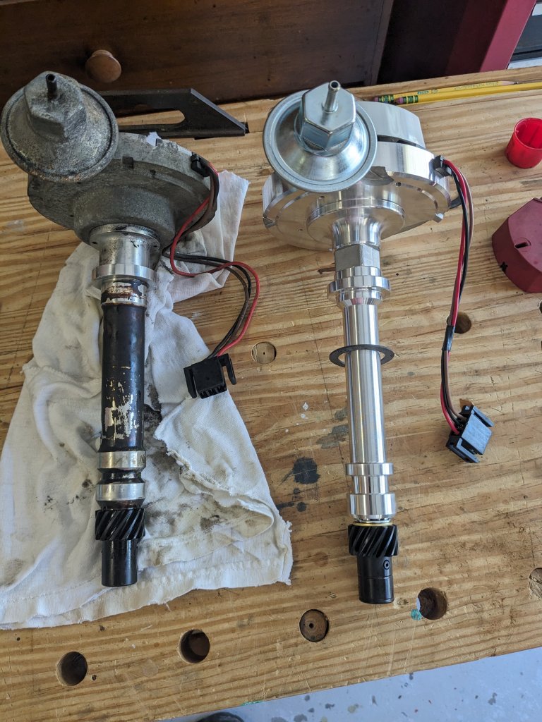

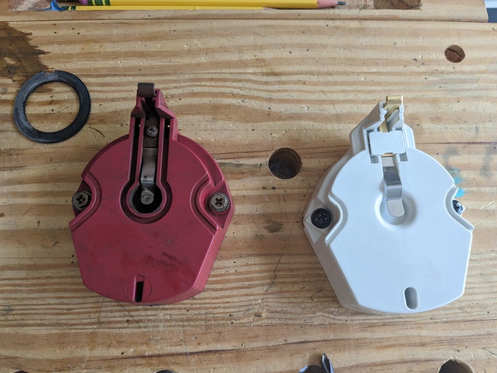

Update:
* New Proform distributor arrived
* Pulled old one and compared (photos attached)
- All the parts of the old one are beefier but I don't see anything too objectionable
* Looked deeper into the old one and discovered the vac advance wasn't working either...
* Installed new one, set initial timing to about 10, checked that mechanical and (ported) vacuum advances were working, yup
* Test drive resulted in a lot of pinging under load
* Set initial timing and idle to values on emissions sticker (4 degrees @ 650(P)), retested and all seems good
I'm going to keep the old distributor. Upon further inspection, it seems fine as long as I replace the offending parts. If the Proform becomes a problem, I'll rebuild the Mallory and use that.
Final post unless the Proform misbehaves.
