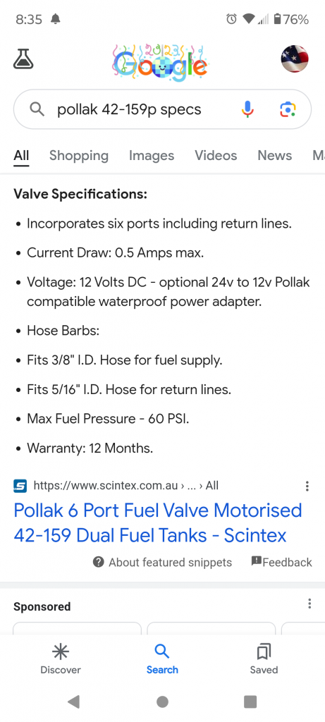

Square, is this what I need? Thanks.
https://www.amazon.com/Pollak-42-159P-Fuel-Selector-Valve/dp/B004BTFL6E

I wouldn't worry about it. The guys on the Edelbrock forum use them at 58 psi. However, except for drag racing every application requires a vacuum referenced regulator. You don't want to be pushing 58 psi at idle and part throttle. It'll be pig rich and the fuel map will be working hard to make it streetable. I run 43 psi on my pf4 and it drops to 30 or less at idle. PSI needs to be compatible with the injector size.

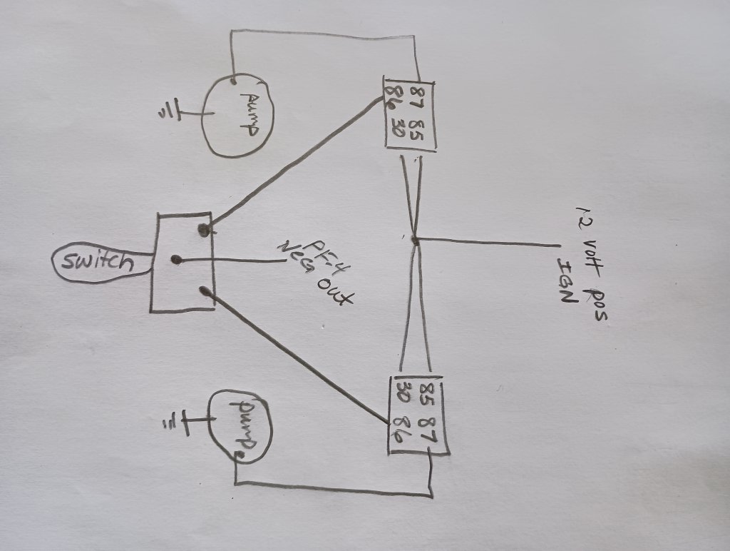

Note, the common ground into the switch can be triggered by the efi output. That will kill the pumps in case of a crash, a nice safety feature. Also, leaving the switch in the middle and hiding it makes a nice security feature cause both pumps are disconnected.

@Doppleganger ,
I plan on using a similar switch setup except incorporate the fuel pump trigger from the PCM to the switch. Switch output will activate the relays which will pass power to the pump
This will allow the PCM to prime the pump for 3 seconds when the key is cycled.
This circuit does that.
