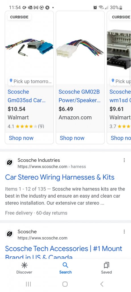

If you find an aftermarket 8track player ( I have one but really want an old cassette super tuner or clarion fir project chevelle) anyway if your wiring hasn't already been hacked you can buy a pigtail,wires to an aftermarket stereo plugs into factory harness. I think one of the companies names is scosche. It's something like that. I'll look BRB
