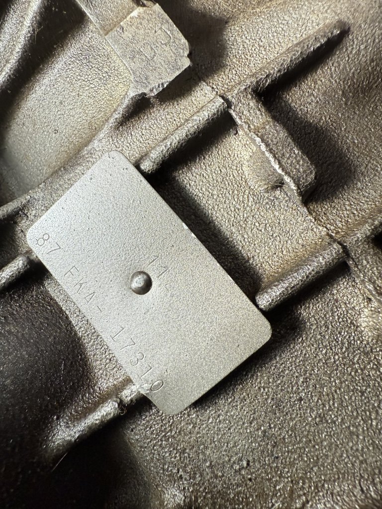

I was able to get access to the transmission tag. If the tag (attached) means what i think it means, the TH400 is a 1987. I can't find a decoder for these tags. I'll drop the pan this week and now I'm expecting a 2 bolt main. Maybe I'll get a pleasant surprise. I feel committed to putting it back to the way it was mechanically when it was original. It was gifted to me, and I want to show my appreciation by respecting the norms.
I just started the disassembly. I'm sure we'll be talking again.
