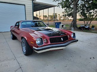

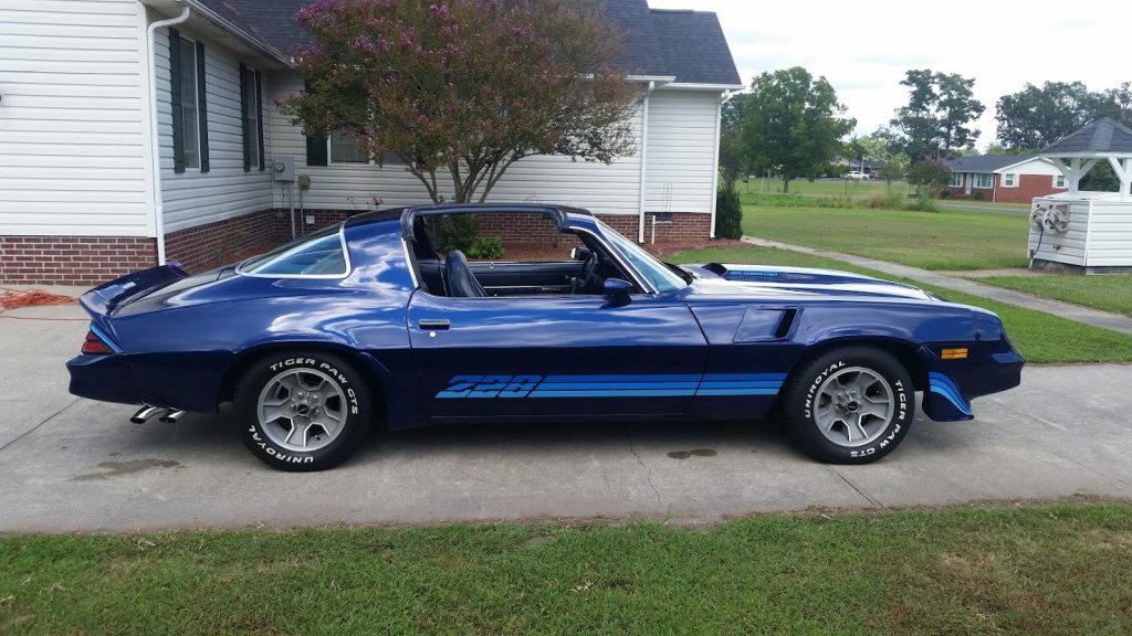

That's a great looking car to start with. I like the Fisher T-Tops and 78-79 Z28 hood. They are easily made into functional hoods. I just sold a 76 that I've been working on for a couple years that had that same hood. I had a really nice 80 Z28 that I sold a few years ago too. It was a T-top car like the 79 you have.
Yeah, the hood I got hasn't been opened up below the scoop yet, but the scoop itself has been modified for functional use. Once it's running and moving under it's own power, I'll figure out exactly how I want to tackle the air induction. I could use an '80-'81 scoop with the flapper, but I have always liked the look of the '79 scoop.
