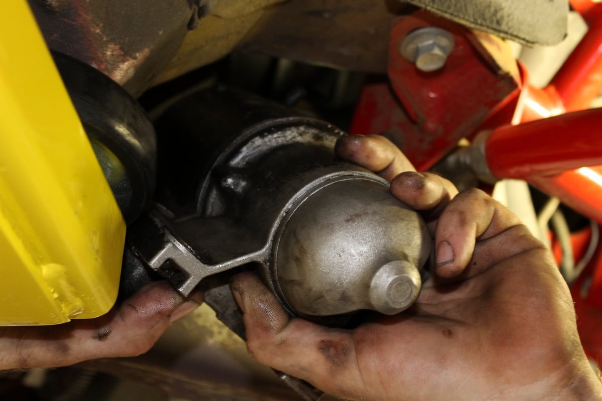

If it is clunking intermittently and not turning over... you have a worn button on the starter solenoid. Pull the starter, undo the screws that hold the plastic cap on the starter solenoid and you see a round button on the bottom of the main starter wire lug. When you engage the starter, it pushes the round plate up onto that button and engages the starter. When that button wears down, you will hear the solenoid engage the round disk(the clunk you hear) but since the lug is worn down it doesn't make contact and the starter wont actually turn. You can unscrew the lug and turn it around so the unworn portion is now making contact with the round disk. This will be functionally equivalent to a brand new lug being installed and should let it keep going for another 20 years or so.
