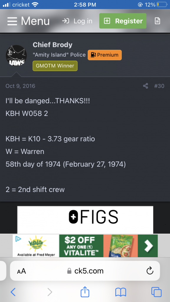

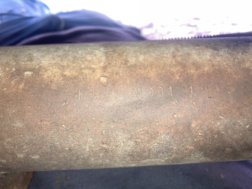

According to this the axle is a 3.73 gear stock axle, how do I go about figuring out wether someone changed the gear ratio?
