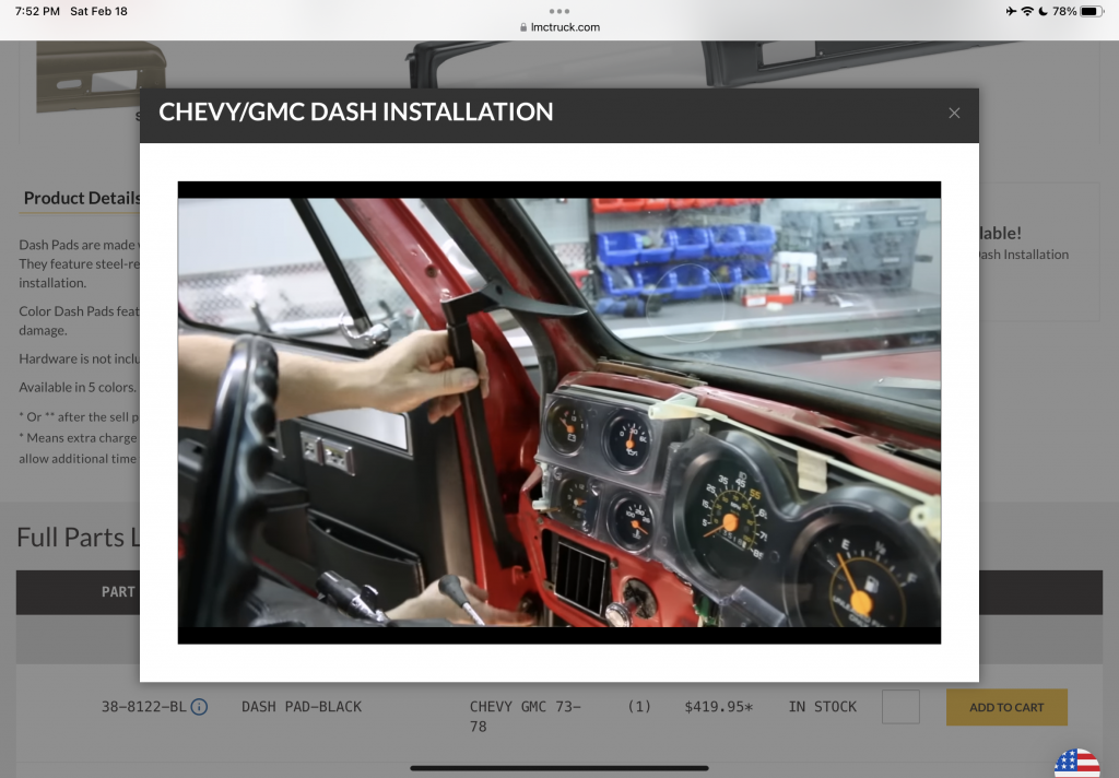

Anyone know what this piece is actually called? Said in this LMC video it’s a dash trim piece and looks like it screws into the upper cab support? I can’t find that trim piece on LMC website, I’m not saying its not there, I maybe looking in wrong area.

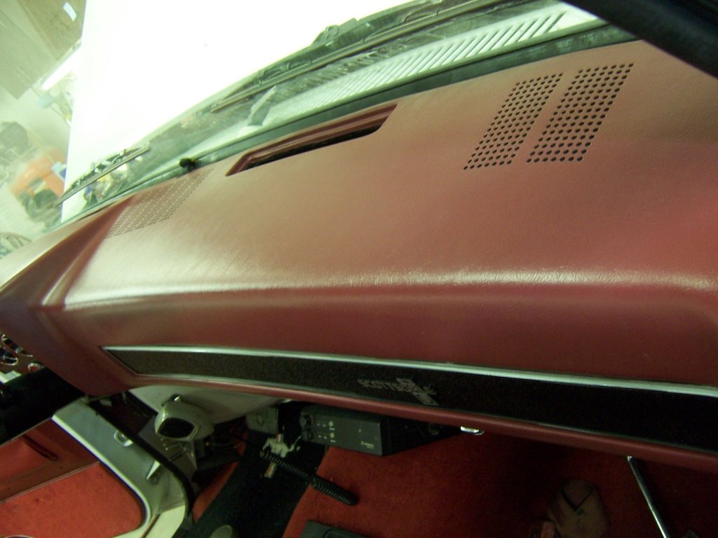

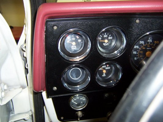

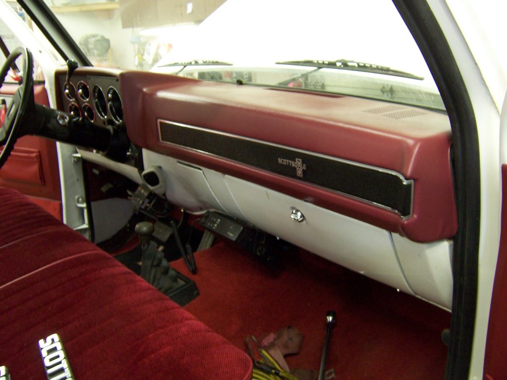

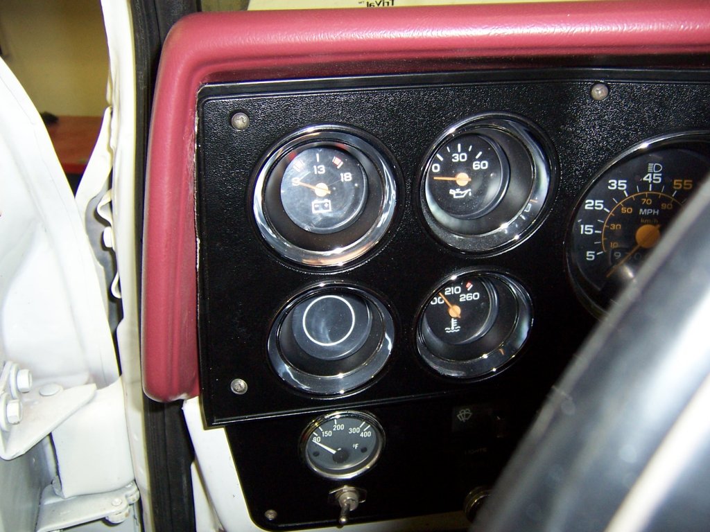

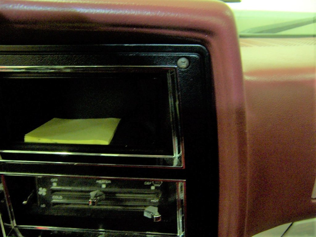

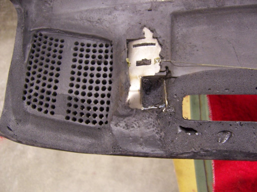

Here's the report on the LMC dash pad I just installed. If this would have been a GM part would have sent it back. However, did get it installed. Took about 4 hours.
The appearance is good, nice grain and color was close enough. Had all sorts of issues with the left cluster bezel area. The opening in the pad is narrower than the bezel. Other problem was underneath where the VIN plate raised boss is. Had to cut the steel out to clear that area. Did require edge trimming. Have no problem with that they say so on the website. I think one of the problems with these is the end result is much thicker than OEM. Had problems with the thickness interfering with the corner speakers. Had to buff some of the material out.
Came from Dashes Direct so you could bypass LMC and go there.
Am thinking this pad came from the same mold as the last one from Classic Industries. The same areas have the same fit issues and they both appear the same from the back. The CI pad was urethane this one is vinyl. The CI pad had horrible waves in the top, this one does not.
Overall, this pad is usable and looks better than a cracked one, but you would be better off recovering an original or finding a used OEM. Unfortunately, the old one was tossed out so that wasn't an option. If it wasn't for the dash bezel area, I would recommend it.

Thanks for the advice. I threw in the towel today and ordered up a cheesy dash cover from Amazon. It’ll cover up the cracks for now until I decide what to do. I realize it does scream “I’m covering up a flaw” but right now, with difficult options, I’m going to wait and see if I can find a reasonable price on reupholstering the original dash.

It's really frustrating all they have to do is copy something. It's the same with many of the other reproduction parts out there. Not just SB trucks. They sort of fit, sort of appear right or sort of work. Doesn't seem to be much that is 100%.
