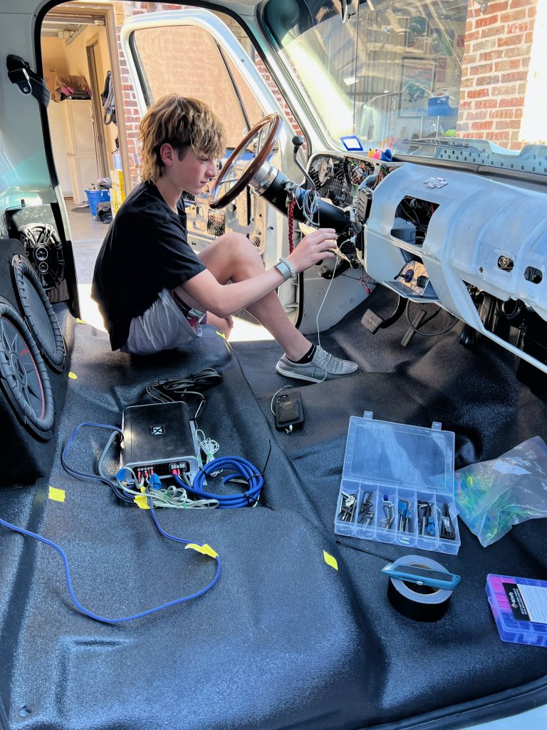

@CalSgt you have a show truck and you are satisfied with the LMC pad? We are in same boat as @fast 99 with USA 1. Waiting since December Easton is not building a show truck so I’m sure he would be happy with the one you have since we are doing a knock off of your build… NOT!
