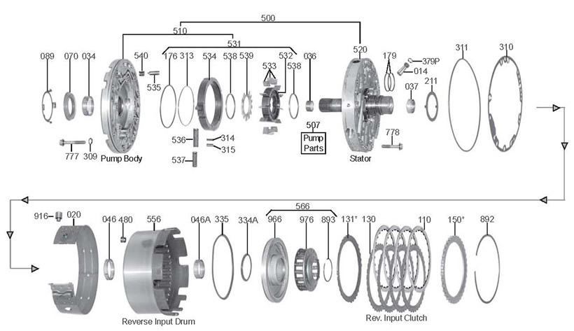

Im rebuilding my 700r4 and when I pulled the pump out a little brass thing that looks like a rivit fell out and I can not figure out where it goes
Any ideas?

dam it looks like a brass fitting. Could you possably get a closer and more focused picture of it?

:roflbow::roflbow::roflbow: That's what alot of people used to say about the anti clunk spring on a Th350, couldn't find where it went so I thru it out. Then they wonder why 20,000 miles later there trans is trash, and I do mean trash. The snap ring is allowed to spin and chew up the lugs inside the case and now the case is trash and not worth rebuilding. That only happens in extreme rare cases, but nonetheless, point is, the part was important and it many times got thrown away.
If its got a hole thru it, then that tells me it likley fits in an orfice somewhere to restrict flow or pressure. I'm getting ready to go do the part time thing now, but I'll do a little research and see what I fan find out. I don't recall see that part. It might even go in the input shaft to resrtict flow to the lock up clutch in the Torque converter. I wonder how that guys trans is doing if he threw that part away??? Maybe it was an aftermarket shift kit part that fell out?? :shrug: May or may not be important.

DOAH just thought of something it could be, how big is the thing, kind of hard to tell with out seeing anything beside it to judge this size in the picture.

I was thinking it might be a part that goes with the boost valve if its aftermarket. But that really wouldn't make sense, cuz how could it get loose? Then, I think it probably goes into an orfice as a restrictor, but it got blown out. :shrug: I haven't looked for any research on it yet. Whudda you thinking it might be?
I am not sure if its small enough. But I am thinking it may very well go into the Reverse input drum. I will see if I can find a picture of one that shows it.
YUP !!! Its either into the Reverse Input Drum, or goes to the band. See #480 or #916 of this exploit on the bottom row.

I'd also check # 540 in the top row of the above diagram. That is what I was thinking it was originally since he said pump, but more than likely, because it was behind the pump and not in the pump, its the reverse input drum.
