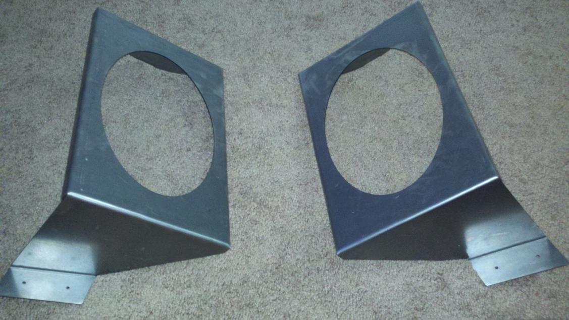

I did some searching and came across another s/b forum that had a guy making these to go behind the seat in place of old cab corners. I went ahead and got a set for $65.

Ive got just a set of the 6x9 boxs behind my seat which sucks cause i cant get it all the way back those will be nice as long as they fit good and tight

I got those same brackets from the same guy, I can't wait to get the time to put them in. Looks to be good quality.

I have some too. I took some time to clean them up and "finish" them to my liking before I get them powder coated:
BEFORE:
AFTER:

At the moment? Mostly metallic, as I trip across them laying on the floor. Mine probably won't be in the truck for 2 years or so. Some of the other guys that have them might be able to chime in though. I've heard nothing but good. I've seen where some people add dynamat or some other sound deadening to the back to keep any extraneous noise and vibration down, which I'd imagine helps the sound quality.

I dont have those exact brackets but made some of my own. They sound like you would expect open-air 6x9s to sound. A little shrill and it dont get better with more volume or bass. Sure sounds better than the roar of Swampers though. Hey Jake are those TIG welds on those corners?

Nope, I used my MIG with .030 wire. I did it a little more on the hot side and just did quick spot welds to get good penetration without blowing through, and then finished the welds with a flap disc.

0.030 under argon or flux? Turned out real good. :waytogo:

I used argon mix. I'm hoping it turns out somewhere close to that good when I do my body work, haha.
