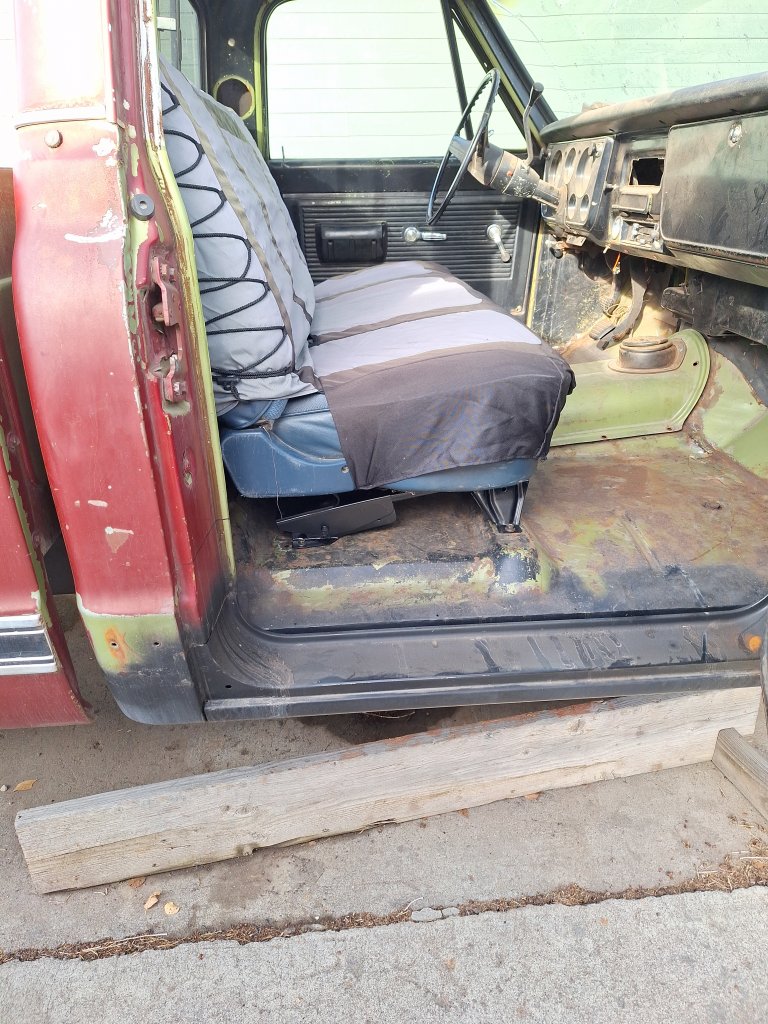

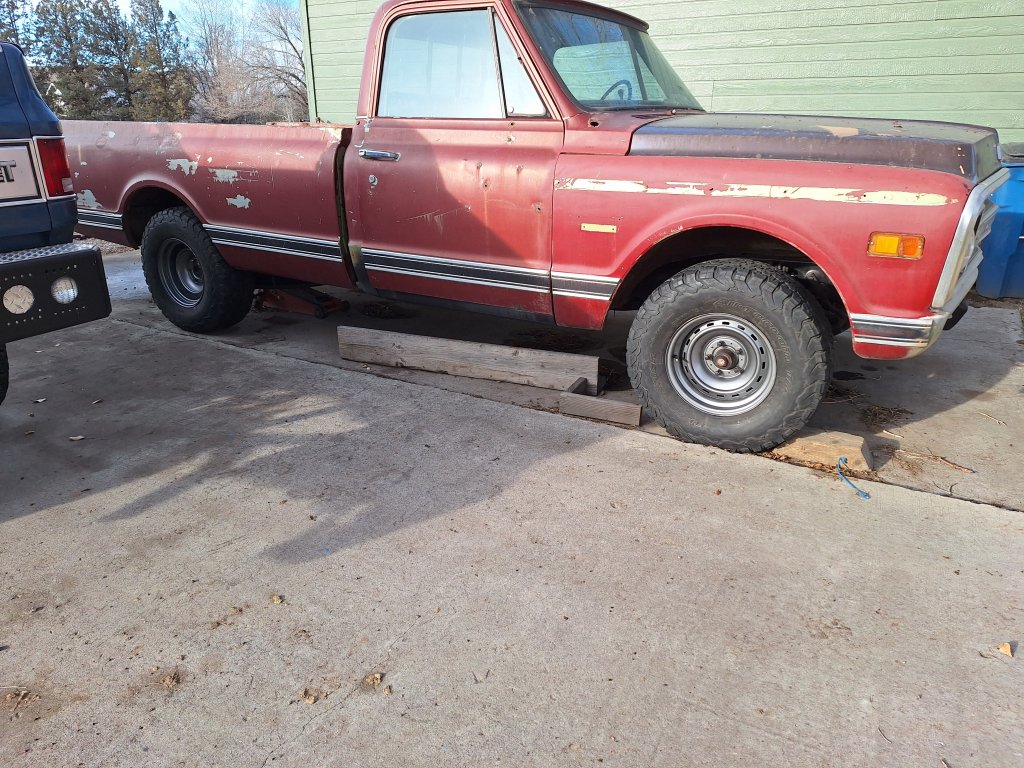

Just painted some ralleys and mounted a set of tires on my 70 C10 project. Adapted a squarebody bench seat into it too so it is starting to look like a truck again. Thanks for the inspiration.

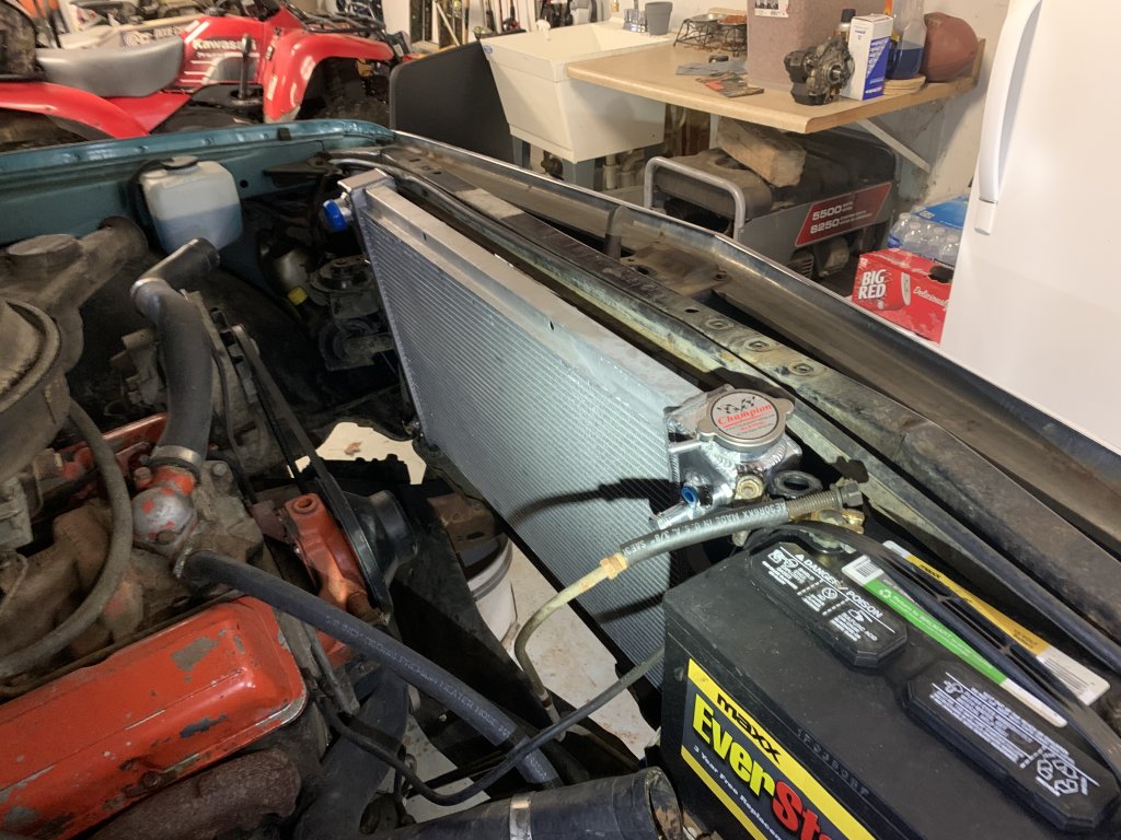

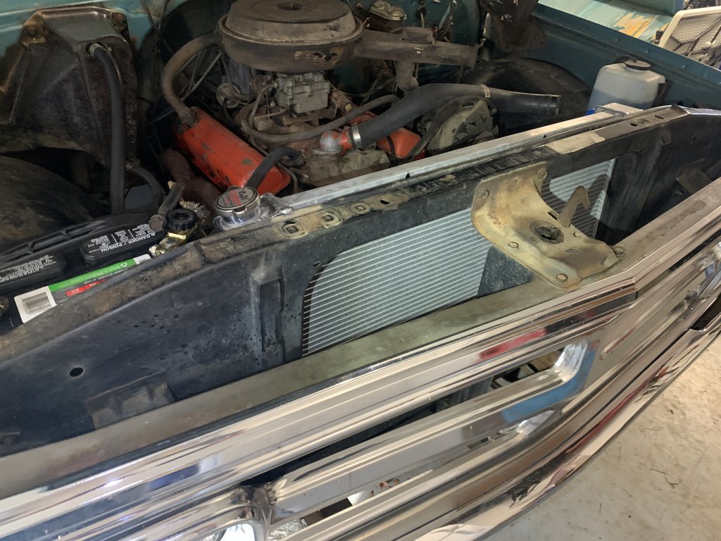

Got a new radiator in yesterday and swapped out the old rusty aftermarket antenna.

Is that antenna from LMC? If so, check to make sure the connection under the cowl end is solid. I bought one for Crusty Biscuit and had illusions of great radio reception. It sucked. When I removed it, I saw how loose the cable end was at the antenna base. Not the nut, the actual terminal that slipped on to the antenna base. We wondered why we couldn't get any radio stations, that was why.

It was brothers trucks. The antenna cord just pressed onto the bottom of the of the base. It’s been raining so I haven’t driven it to see how the tunes come in yet.

That's what it was with the antenna I mentioned. If you have crappy reception, check that connection.
