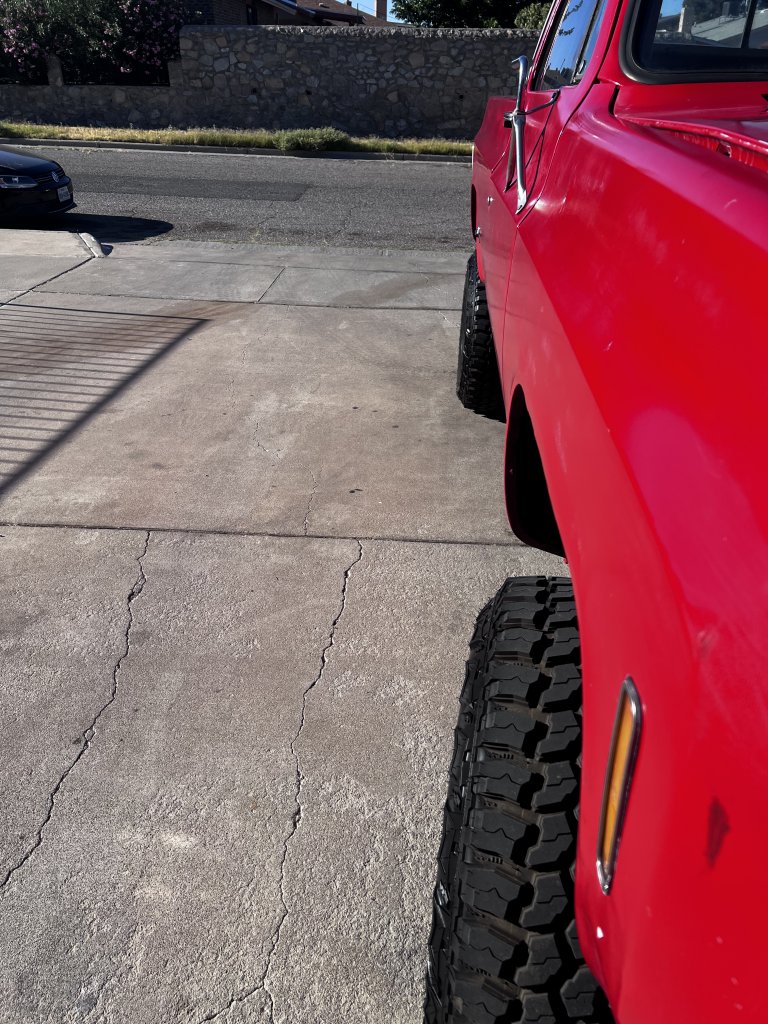

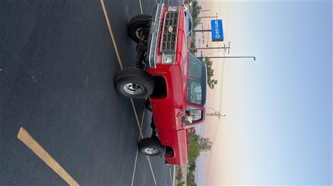

So i got my wheels and tires installed and it looks good.
Thanks for all the input.

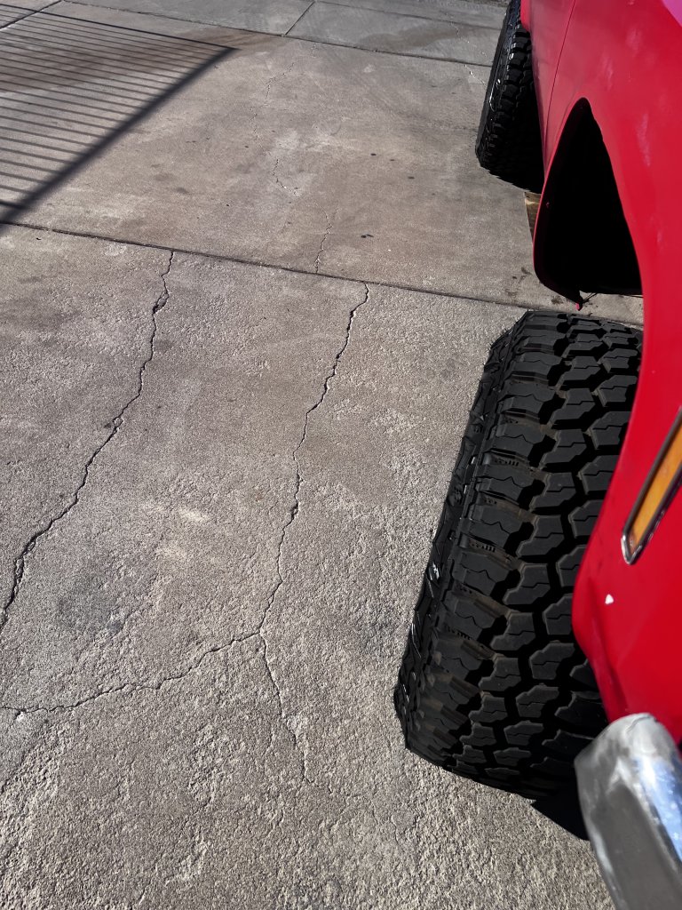

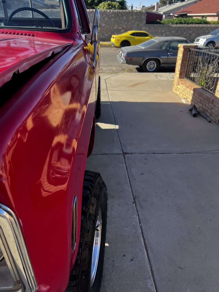

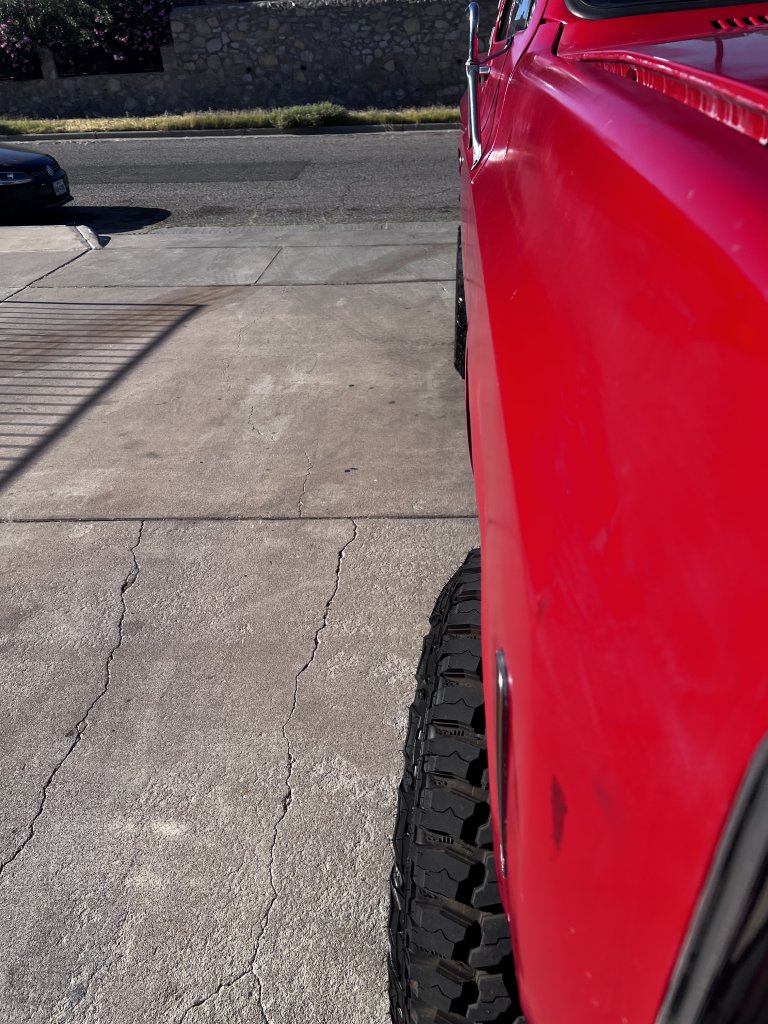

Have any more pictures? How far out from the fender do the tires extend?
Big red square
Dec 7, 2022
93
76
El Paso
Lewis
Not as far as I wanted
