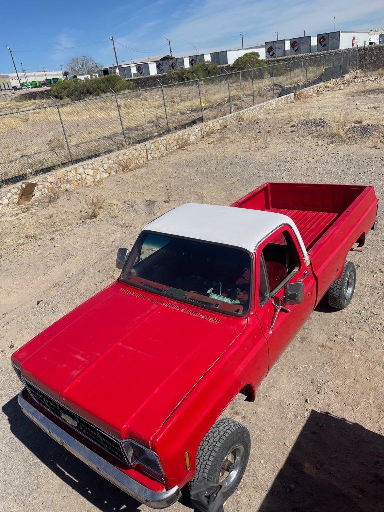

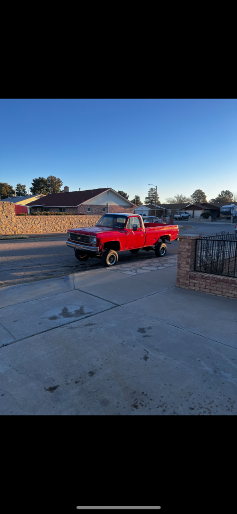

6" lift what wheel and tire size can I fit? I want 35's but don't know how wide of a tire and rim i can fit.
Please post pics so I can compare.
