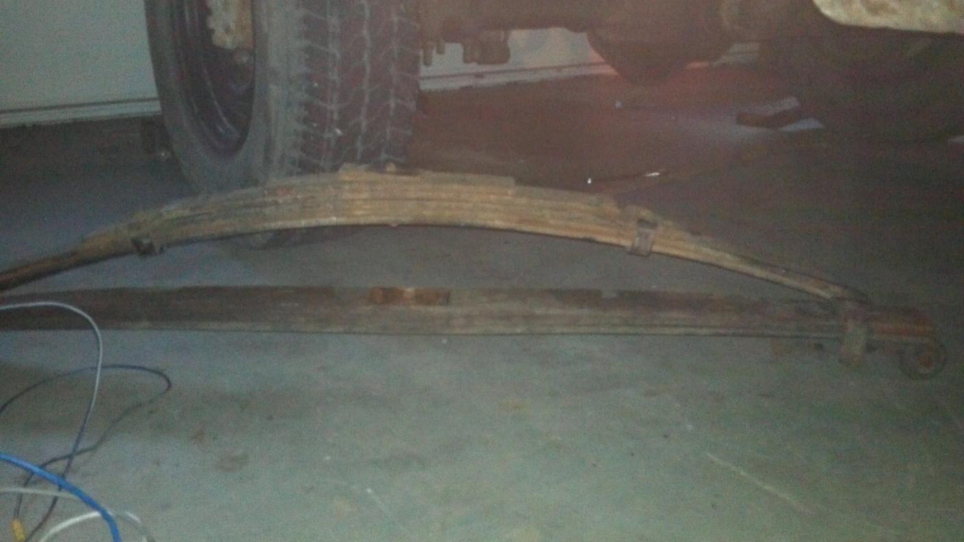

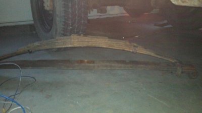

since we are on the subject of figuring out lift springs how about this one? I havent thown a tape on it to check the differece yet i just took a quick pick.
Hard to tell when they are not installed. Look like 6 inch though.

They look close to my 6" springs on my floor. I'll try and get a pic for you.

Here this may help you. The more I look at yours, they look like 5 leafs when mine are 6. I'm thinking maybe you have the 4" pack.
