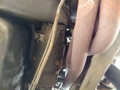

Ok, so how do I remove the starter with steel tranny cooler lines and long tube headers in the way? Looks like I may need to remove passenger side exhaust just to get starter out. That'll suck since all the exhaust mounting points are rusted solid.
My starter still works OK, but it's running slow from the 100 mph run I did a few months ago.
Thx.

Would anyone happen to know the part# of the starter heat shield?
BTW, this is probably the best writeup on how to change an SBC starter that i've seen so far.

Remove bolts holding those stupid braces that run from the engine to the bell housing cover. They are 5/8" socket. I was able to just take the 2 bolts out of the bell housing end and the braces swung away far enough to clear removal.
