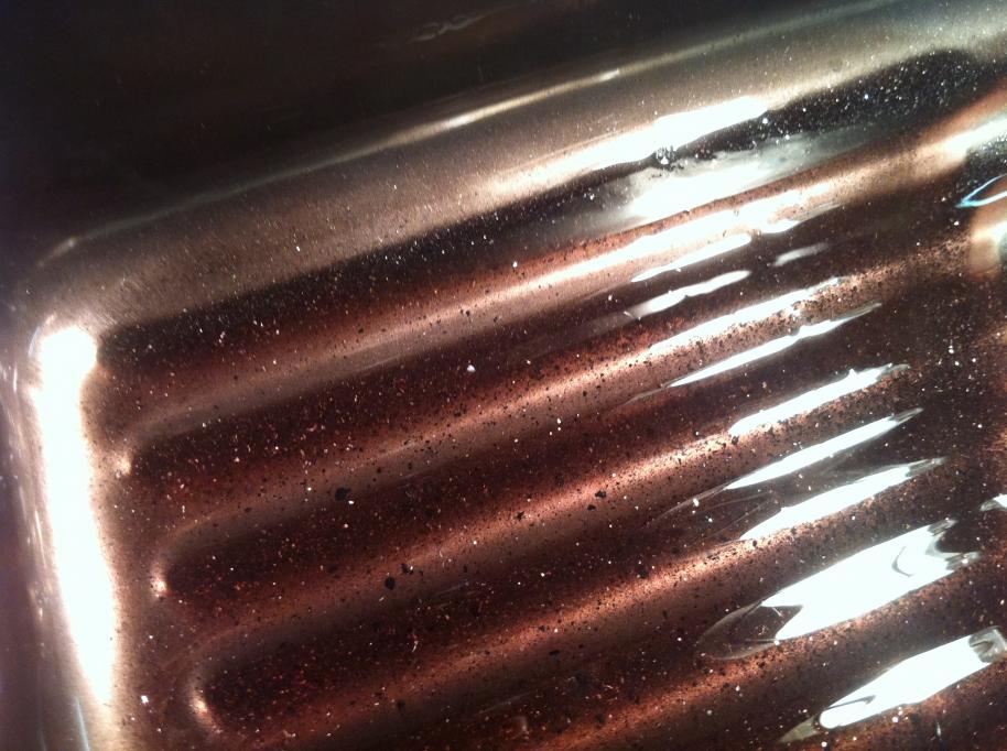

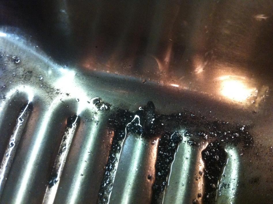

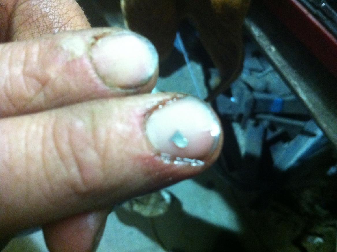

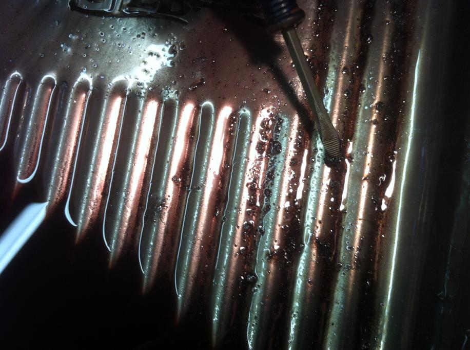

I called them today They asked me to remove the pan to look. it has gold,silver metal flake and pepper in it but no large parts. not good It has to go back .

I was holding off but . after i am getting the shaft with shipping for 150.00 back and no parts,fluid,and labor to do it again. like i need the practice. i have done over 100 tranny swaps.. because i don't have certification in front of my name i get boned. I have to wait for the bill of laden then remove it then ship it back. one week on the truck and one week getting rebuilt. then one week coming back . 3 weeks of rental car 125.00 per week +56.00 fluid and 6 hrs on the lift. I will never recommend MONSTER TRANSMISSION to anyone again. I even took the stickers off out mud truck.
Its not like i did anything wrong I installed it 100 % correct there workmanship was bad on this one. and I have to pay for it. its ok the web has a long reach this is one of my do not buy complaints .3rd gear is smoked and reverse is 1/2 smoked. and shifts like **** 1 to 2nd. nothing like my last one.its to bad they advertise to anyone on the web but fine print you should have a ASE installer. its bs . plain and simple there **** was weak. it didn't make it 5 miles back home before it was fairing up.
