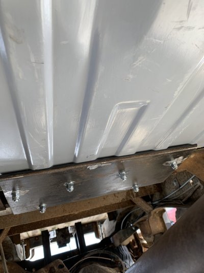

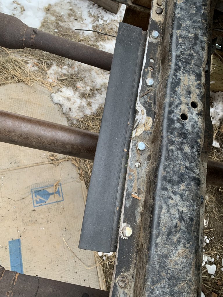

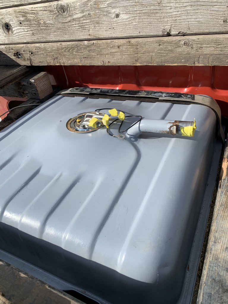

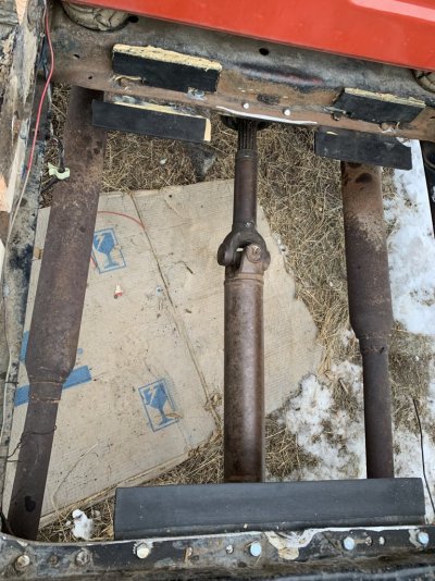

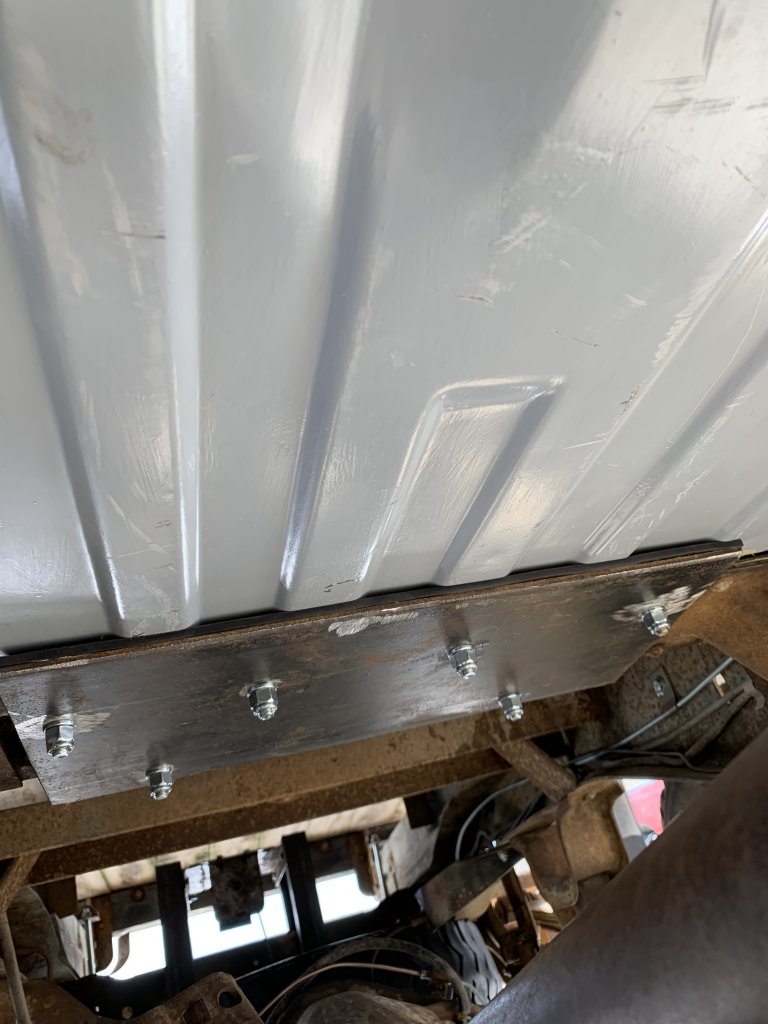

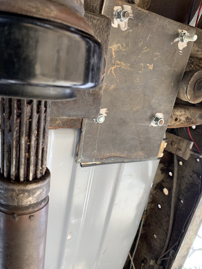

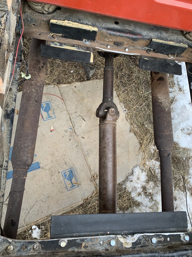

I took out my dual tanks and put this 75 Suburban tank in between the frame channels just behind the cab. A guy at the wrecking yard said I could put a 72 tank behind the seat but I can use that space for storage. The sending unit that was in the tank works fine with my gauge.

Do you have a fleetside bed on this or a flatbed? Interested in what you did for filler neck routing
Your axle , for sure, can NOT travel enough that it would be getting uncomfortably close, right? Id think since you have a center support that putting it there gives you the best safety but Id wonder if a load in bed and some torque wind up would pose a danger or something.
You wanted 1 tank im guessing, but if you could find onthats long and shaped like a right triangle almost you could get a lot of fuel to sit inboard the frame and never be at danger but it would be hard to find one youd have to get way more into it lol
It’s a wood framed flatbed. Yes I meant to mention that the stock box bed might be too low for this. Like I said in the “ can’t decide” thread, the tube on the tank clears the under side of my bed and goes level, like in the Suburban it came from, up to about 10” I guess from the last north spout. 10” away from the spout it turns up about 5 or so inches. My plan is to go back to the wrecker and get that spout that’s welded to the body. And put it inside a heavy steel tool box that has a door hinged at the bottom.
Yes, this tank is way away from the axle. And about 6” above the driveshaft. Thanks for the heads up
I see now you have what looks like a wood bed and your setup here stands far up :)
