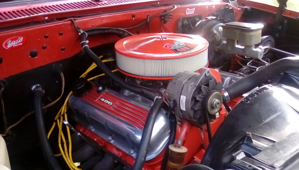

Welcome from Ohio. I'm old school, I'd recommend big block. I'm old, drive around gently and my 496 is surprisingly better on fuel than my last truck with a 350.
