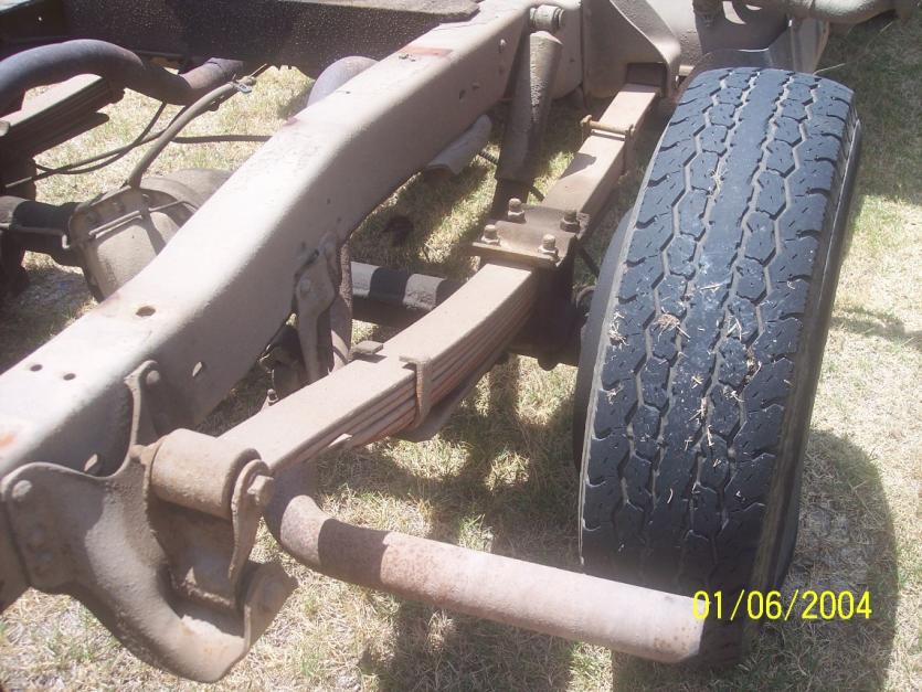

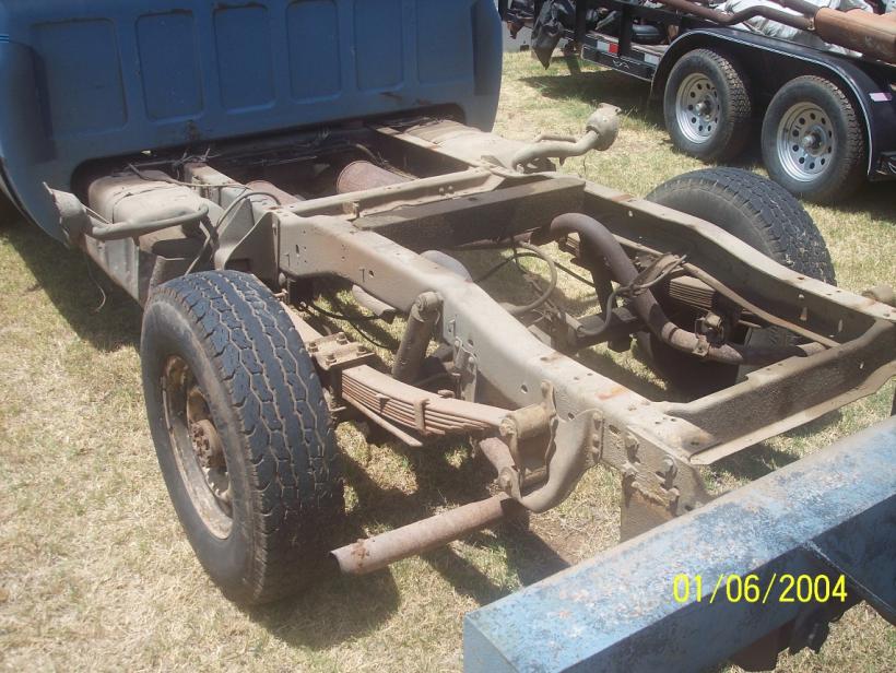

Looks like a 1 ton set up to me. I know the shocks are 1 ton set up. Spring perches look close to the frame, which will make the spring perch distance more narrow.
47,210
9,482
This is a 3/4 ton set up. Notice the difference in spring hanger distance to the frame, and notice the direction of the shocks.
