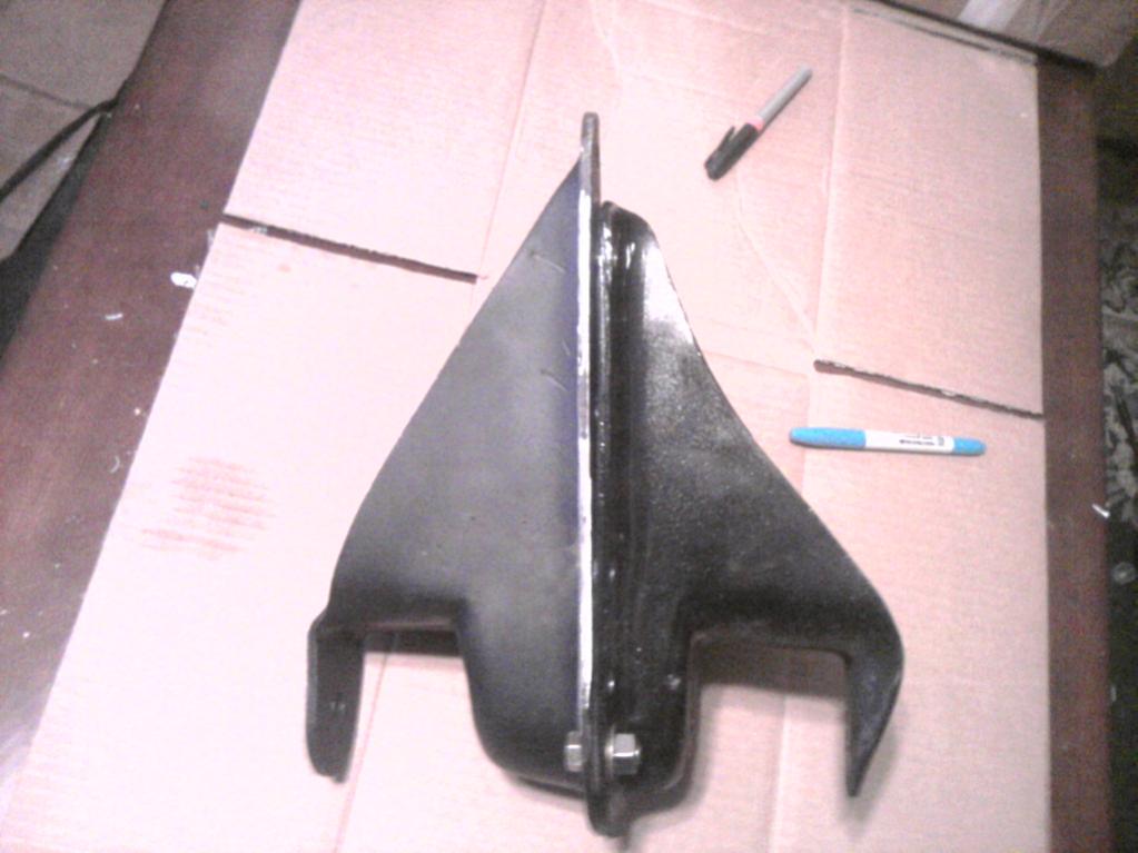

3/4 ton hanger bolted back to back with a 1 ton hanger
and if you ever need to put a 3/4 ton axle in a 1 ton i found a easy way to change spring hangers i did it to my 4x4 crew. details are in my build thread
