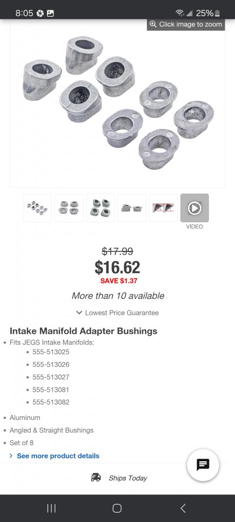

Thanks for the correction. I forget there are 8 and 12 vertical bolt intakes. As well as half angled and half vertical. My Vortec blocks all had/have old school pattern heads.
Air gap style that fits everything but the 8 vertical bolt style.

Just the bushings for those interested.
