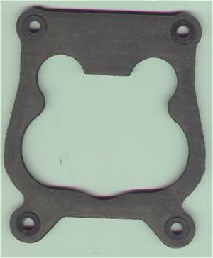

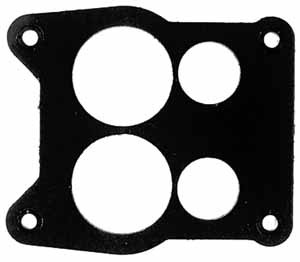

I do have a question though. The new gasket came, one side is textured and the other smoother. which side points where?

It probably doesn't matter if both surfaces (carb/manifold) are smooth.
But on any component that may have to come off in the future, I always use a tiny bit of adhesive (or silicone)to bond the gasket to the removable part. The other face of the gasket (the one that goes against the mounting surface of the stationary component) gets a good coat of never-seize.
That way, when the time comes to remove it, the gasket will stay with the part and the other side wont tear as it is pulled off. Carburetor gaskets have a tendency to break up upon removal if you just make the joint up dry.

Okay, thanks for the tip. just got the carby off, gonna run to the store for some type of sealant. and you're right better safe then sorry.

I use blue RTV, but about any of it will work.
