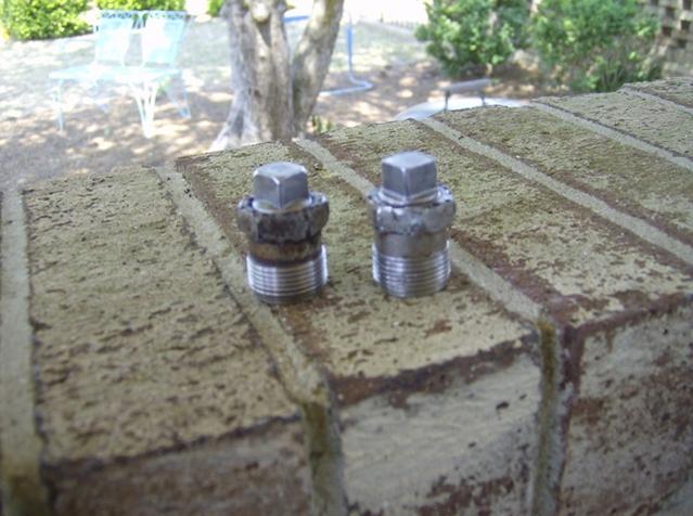

Like these?
It won't be hard - those injection tubes pop right out:
Unscrew the fittings, pull the nozzles out with a pair of needle nose or a pick. Find or make a piece of sheet metal the same diameter as the nozzle (where it sits in under the fitting) and then just screw the fitting back in.
The port will be blocked off to atmosphere and it will still look good.
Probably a penny or a nickel would fit right in the bore.
