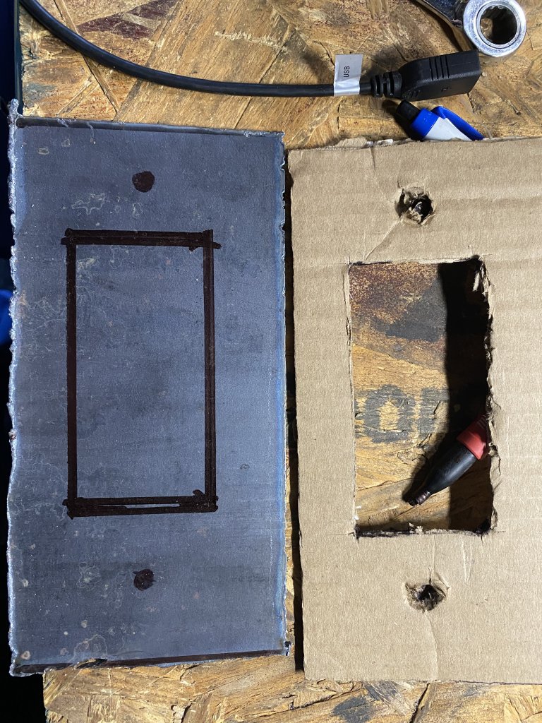

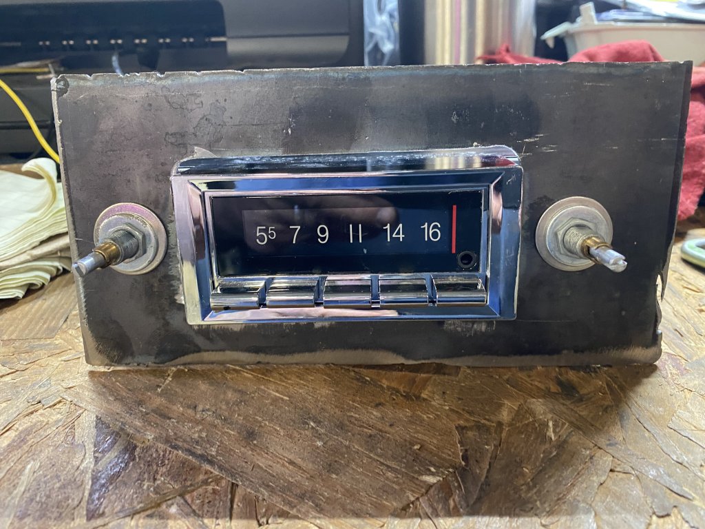

I'm having trouble find a radio patch panel for a 1978 k10. The previous owner cut the radio panel way to big for a newer radio. So I either need a patch panel or a whole new lower dash. My local junkyards have squarebodys but they all been gutted already. If someone could help me find what I need. Thank you
I made one that I’ll be doing a write up on very soon
