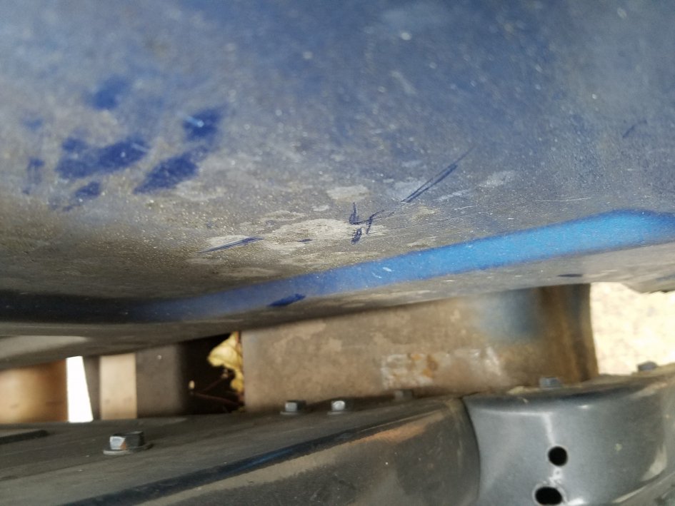

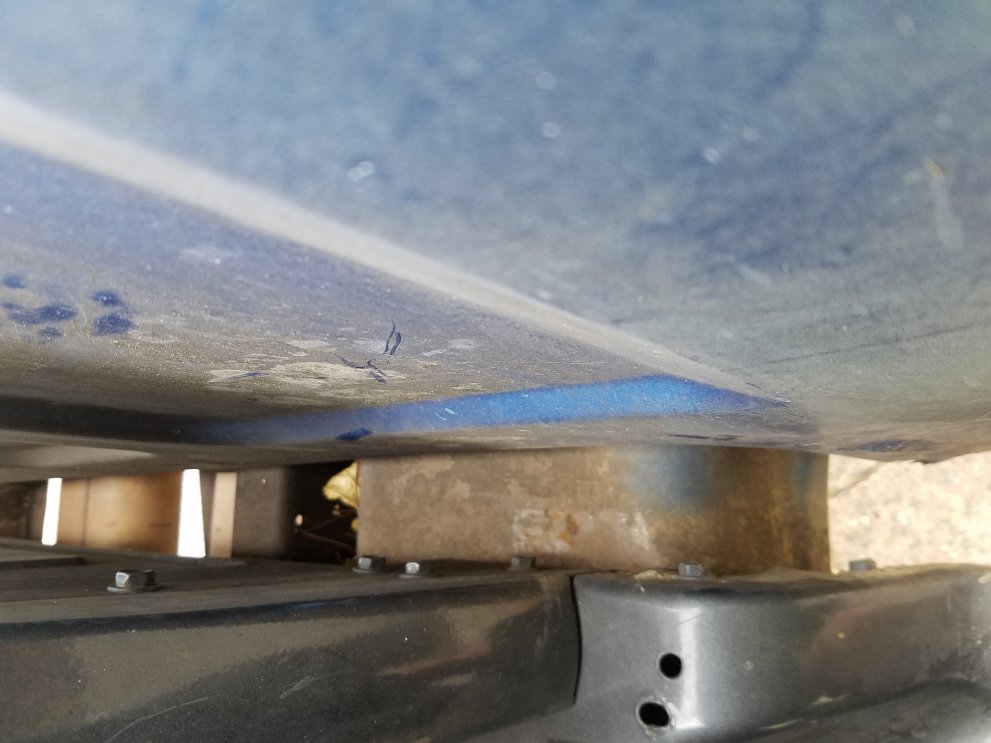

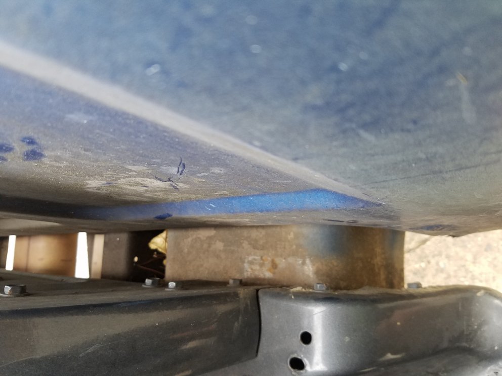

My step side box that the PO swapped on sits lower at the passenger side by the tailgate, it also seems to hit the gas tank next to the frame on the passenger side. You probably can't tell from the picture, but I am able to grab underneath the step and lift it about 2-3 inches.

Kinda need to get a good look at things on the underside. The bed has cross sills that tie the bedsides together and give the wood floor something to lay on. A couple of those sills (they are stamper steel) may be crushed/rusted or just plain missing.

I started to fool around in the cabinet and found that the previous owner had purchased the bed mounting hardware from LMC truck, they went as far as laying 4 bolts into the holes, they just never put washers or even nuts on their, so I did all that today with front most 2, and the second to rear most two, the second from the front had a weird pipe dead that went all the way through the frame and the very rear parts that were part of the box assembly, one was broken and bent, which was causing the passenger side to sag right at the tailgate. I will take pictures of the gas tank tomorrow morning, it looks as though the bed still touches it, but it no longer lifts and slams into it. I believe they swapped gas tanks when they switched from fleet side to step side and they may have mounted the fuel cell the high.
