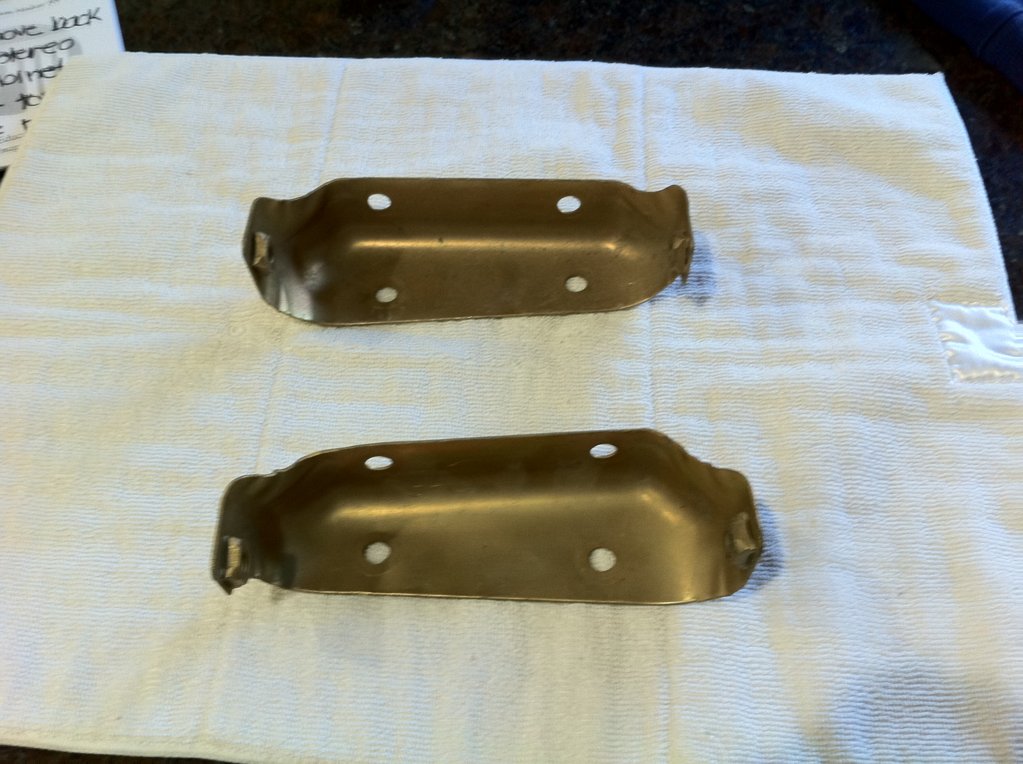

If any body can see these pictures, can you please tell me what they are. They are off a 1974 K10.

If you can see the bracket pictures when you scroll up, do you know what they are for. It's been so long since I took them off, and I can't find anything in my manuals on them, I've forgotten what they are. Thx for any help.

Those parts don't look familiar, but I'm a newbie.
