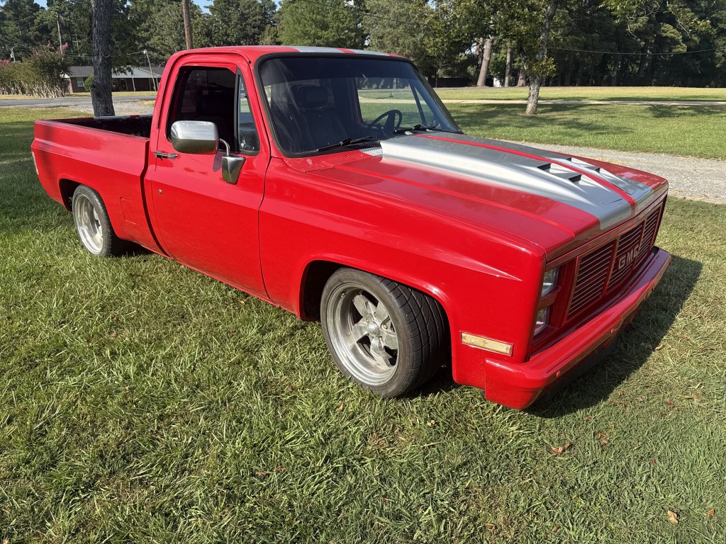

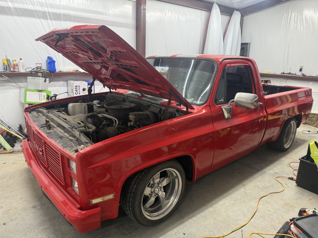

Cool thank you. What front tire are you planning?
I'm running a Mickey Tompson sportsman all the way around 26x6/17 up front because of the fender well headers I needed a narrower wheel to clear while turning, If they would have had a 4-inch front in a 15 I would have ran that instead of the 17, the rears are 28x12/15s

No mods or spacers they fit fine also the 20s were 5.75BS and they didn't rub either.
I got some work to do on it tomorrow, while I'm out there I'll take some pics of the fit on the backside of the tire to wheel wells and to the wheel arch.
Looks good. I just looked under my truck, it had been a while and I remembered wrong. 5.5BS will fit fine.

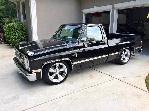

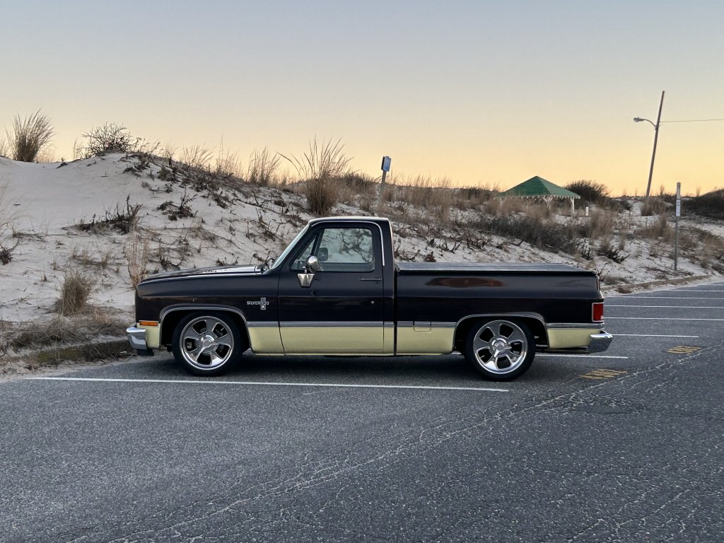

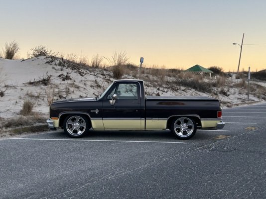

Beach pic has 245/45 20 front 275/45 20 rear, other pic is 255/45 20 front, 295/45 20
Those are another on my hot list. I think they’re boulevards? I also like Salt Flat 20” on these trucks.
