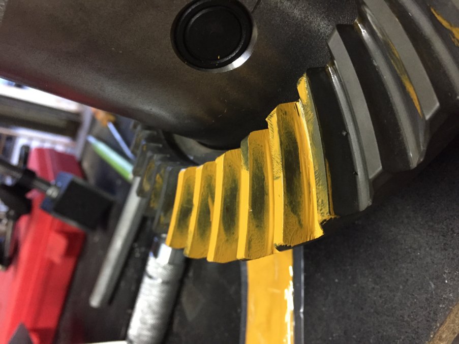

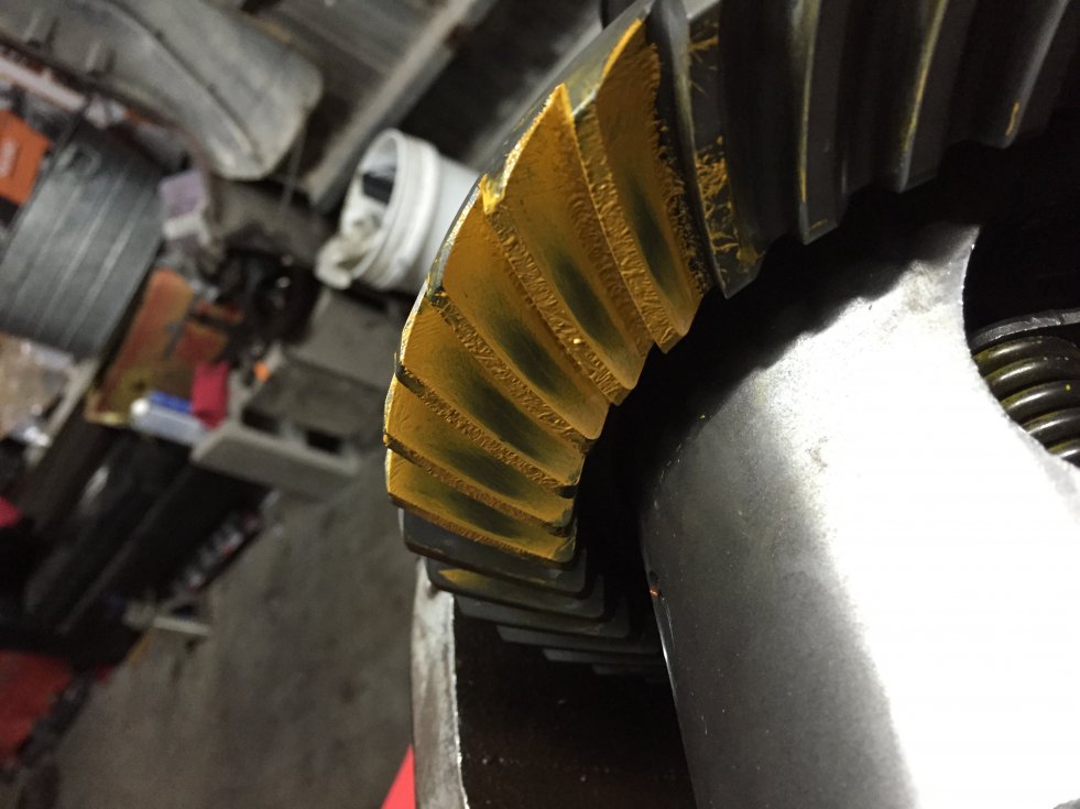

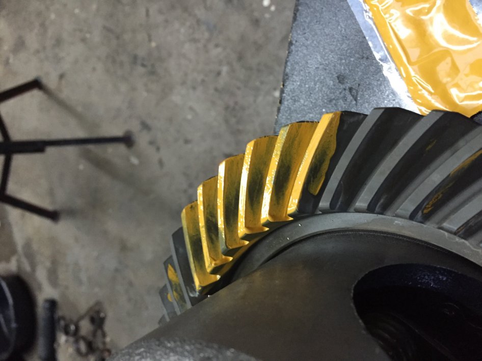

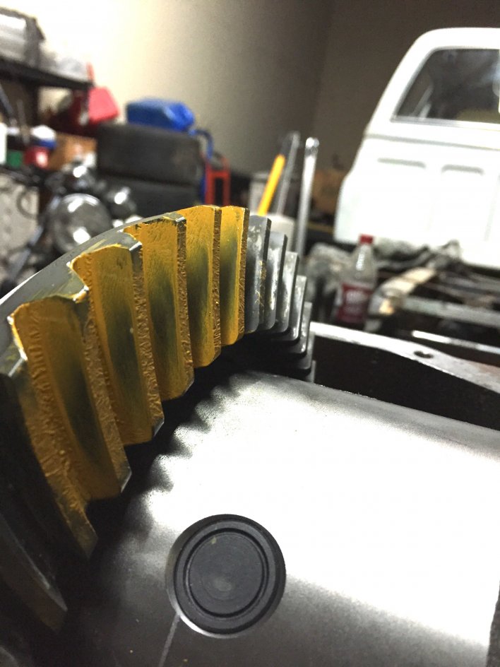

Hello all. New to the site, lots of good info. Im currently building a 12 bolt for my 86 and wanted some opinions on what everyone thought my gear pattern looked like. The first pic is at .027 pinion shim and .006 backlash. The second is .030 and .006 bl. Thanks for your input!
