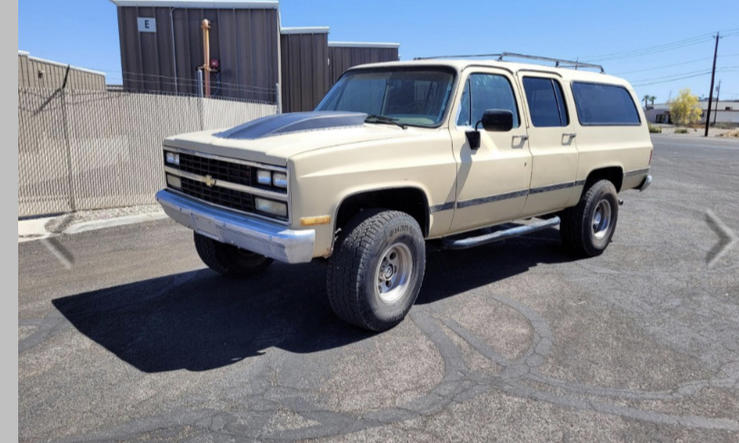

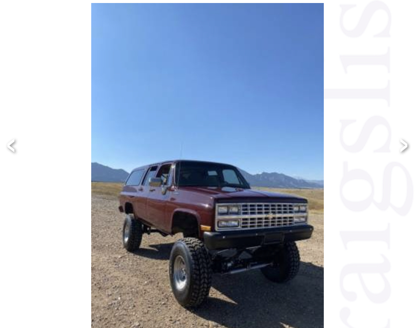

Hey guys I am looking for opinions here on the best lift kit and parts needed to run a 37 inch tire. My rig is mostly going to be for highway use but I’d like to have a big lift kit on it since it’s being wrapped for my company.

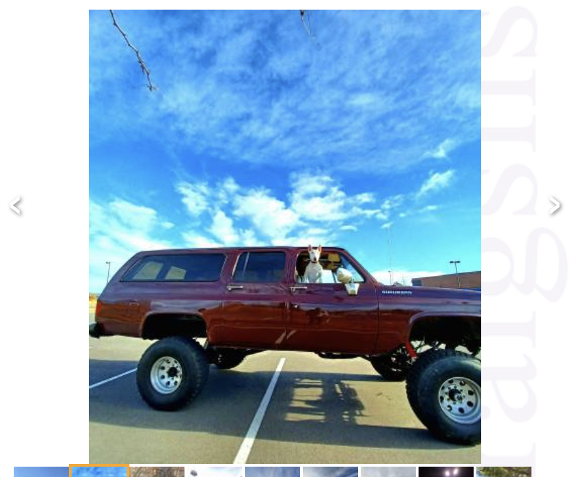

Attaching pictures of my rig as it sits now, it’s the tan one, along with pictures of a red one that has the look I am going for.
As far as axles go I’m pretty sure I have 12 Bolts in the front and back and since I am buying the truck I am not really sure about the gear ratio just yet.
With that being said I am looking for a ideal gear ratio for highway use and light off roading, Along with be ideal and cost effective way to upgrade or swap my axles if that is needed

Unca Nick,, we need more data. Engine, transmission please. Gonna need about a 4.10 gear swap.. hopefully they make them for the 12 bolt. Normally I'm the guy coming from actual off road worthiness and would say never run tire that large on 12 bolts.. but you said it was for looks and highway.
So you probably don't want to do fender cutting? Or maybe just a little, like the front 'horns' ? And then that could ead to a new front bumper like perhaps a pre-runner tube style that would suite the fender trim. Cut the that fender 'horn' or some guys call it the 'fange', but cut right under the horizontal marker light.
My suspension recipe would be Tough country 4" lift springs, a 1" easy-inch from ORD... a 1" body lift kit. While your doing the body lift, and ALL the mounts are loose, try to slide the entire body back as far as you can on the body mounts. If you .5 - .75 of an inch your doing good. Every bit will help. The easy-inch bolts right into your spring pack, from the bottom. It has offset spring pin holes so you can move your front axle forward. Are you seeing where this is going? You're making tire clearance to the firewall.
Your tire selection will also effect the possibility or not of connecting rubber to metal. Since your goal is road driving, I would assume you'll be after a not too aggressive all-terrain type of tire. You can have better luck with tire clearance with this type of tire over say, a mudder.. with big side lugs that reduce tire to firewall side fender clearance. And when a mudder's lug comes up and grabs metal there will be a lot of damage. A smooth AT without big lugs will rub but not catch.
I think the lift on the red Burb is way too much, imo. Also please don't go any larger than 178" rims.
You can use a shackle flip for the rear lift or even blocks since your not rooting around off road getting tire hop.

I think your truck as it sits looks way better then the red one.
I would do a 4 inch lift 1 inch body and 33s or 35s. I think it would look better.

Thanks for the input guys- I’m not sure but I think mine may have a small lift and 33inch tires currently (I’m picking it up from out of state next week).
@shiftpro :
I have a 350sbc motor and standard 350 transmission I’m pretty sure.
If I do 37 inch tires I’d do ones exactly like the red suburban I posted the photos of.
I do quite a bit of highway driving so I would really like to go the extra mile to stabilize the suspension if I go that big. I know the lift on the red truck looks pretty extra but since this will be for a company vehicle I really want it to stand out and be a showstopper.
Do you guys think a 2 inch body lift would be too much? I am wondering if I can save a little bit of money doing it this way and then maybe just do an 8 inch suspension lift and get a little extra clearance by doing shackles on the leaf springs.
One thing I am wondering on this is at what point with the lift kit size do I need to get longer drive shafts? Also wondering what implications this has on the steering arm or Pitman arm. I haven’t seen the steering box set up but I would imagine I would need to extend it in someway and want to make sure I am getting everything in the rough country kit.
Do you guys have any opinions on the skyjacker lift kits? I’m not sure rough country goes up to 8 inches but I could be wrong. It seems like skyjacker is the only one with a lift above 6 inches for this vehicle. Like I said having a stable smooth ride on the highway is my primary concern. The most off-road and I am going to be doing is muddy back roads and some light trails but no rock crawling or anything.
I have also seen a lot of guys on the forum talking about braking ability when you run a big tire. Do you guys think doing a larger master cylinder would be a fix for this so I don’t have to do a rear disc brake conversion?

The lifted red burb is trimmed, so I guess you aren’t opposed to that. Is a 10” lift necessary for 37s with other accommodations in place?
I think shiftpro’s recipe is a good one, even if it takes 6” of suspension lift to get it done. If drivability is important, I don’t think you can cheap out on a bigger lift.
You know anybody with a truck near the height of the red one? Ask them to drive it. See if you can live with the way it’s going to drive. A truck with more than a 6” leaf spring lift is going to have compromises. The spring arch with be pretty curvy. Depending on budget coils would be something to look at.

I have to agree with some of these other folks in that I would definitely NOT put 10 inches of lift on a Sub; not even to do "mall crawling" with. A 6 inch lift and some 37's will be fine and it appears that your Sub is already a 20 Series with a 10 bolt front and 14 bolt rear. These should be geared 3.73 or 4.10 and will turn 37's decently.
You'll have to do driveshaft and brake hose modifications with the 6 inch lift but as long as you're not going rockin' or twistin' then you shouldn't experience too much fender rub; especially when using a 10 inch wheel. Now, if you plan on the "stance" like these squat freaks love then you may as well invest in the big lift kit as 14 wides are gonna rub unless you lift it to the moon.
I hope you can tell by my comments that the red Sub is not my kind of build...or ride. Thanks.

I'll throw my hat in here. Based on what I see in the photo of the tan Suburban I'm guessing you have a 3/4 ton. An '88 should have stacked headlights unless the grill was updated. There's probably a 3-4" lift sitting on 35's. Those could be 16.5" or 16" wheels. The OEM engine would be a low HP 350 and and either a TH-400 or maybe an overdrive. As others have said 3.73's or 4.10's.
The picture below is my '77 K5. 6" Skyjacker soft ride all spring lift. The tires were 15/36R16.5" tires on 9.75" wide wheels. Main reason for the cut out flares was due to some wheel well rust the flairs allowed me to remove.
The K5 had a SBC 400 and 4.10's. It did okay power wise, but 4.56's or 4.88's would have been better, especially in your case with a Suburban due to the weight. I had a raised steering arm plus an "S" shaped drag link. I kept the front sway bar, but due to tire/suspension flex it kinda wandered on the road. I got a lot of bump steer even though I had done everything to set up the suspension correctly. There was even a dual steering stabilizer.
What you're trying to do would be fine for mall crawling, but for any highway/freeway driving, I wouldn't recommend it. With and 8-10" lift you will not get a lot of spring flex and the truck would be very rigid. Sidewall flex would be most of your suspension. I had several friends in the late 80's-early 90's that had Square Bodies with 10-12" lifts and 44's. Most were useless except to hit the cruise route in town or a mud bog.
It was a a police officer for 27 years. Part of my expertise was a driving instructor and traffic collision investigator. I went to plenty of roll over collisions over the years. My concern for something as big as you're describing is stability in an evasive maneuver.
I'm not trying to discourage you, but keep these things in mind during your build.
