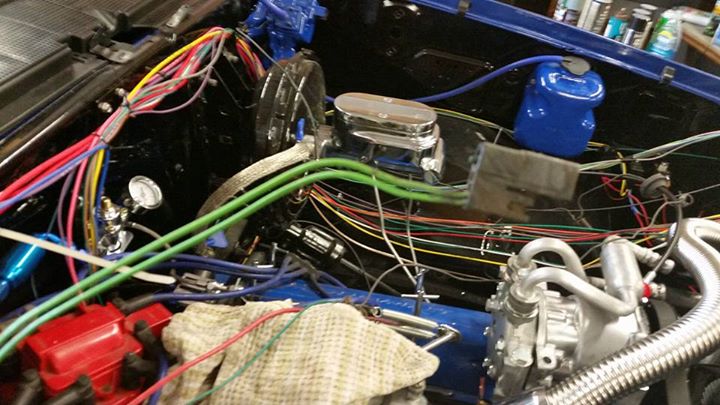

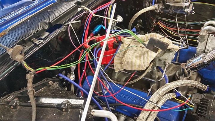

Trying to find out where this plug goes on my 83 c10, it comes off the harness to ac stuff before it goes in firewall, it got 2 green wires going into same side of plug and look like a wire was cut off on other side of plug, black plug in center of drawing, one side longer than other

Don't have one and if I don't need it I'll cut it off

Cover the end of the wire. If it makes contact with a ground when the mode lever is set to the AC positions you'll blow the heater fuse and the blower will stop working.
