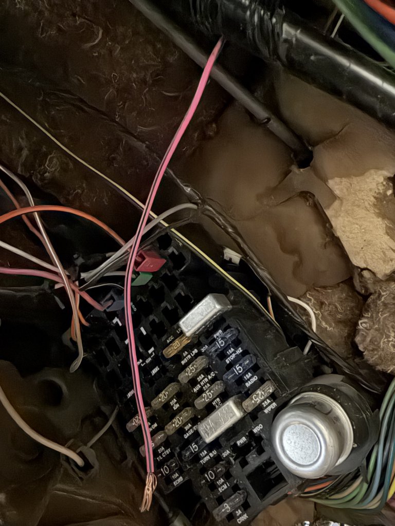

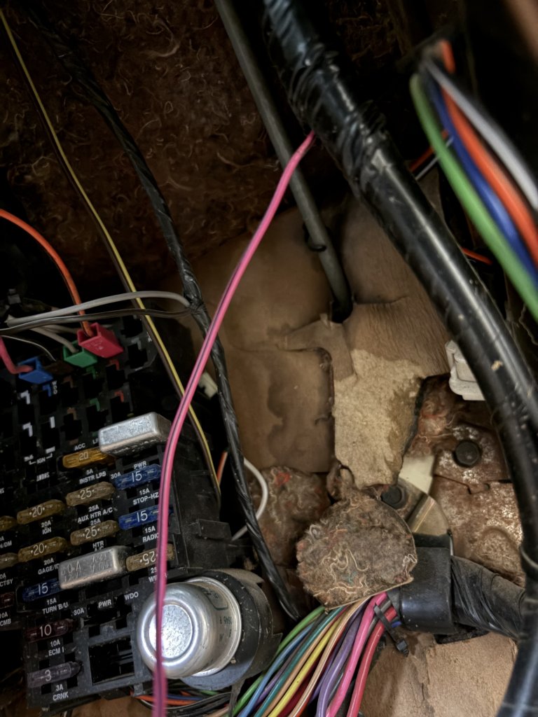

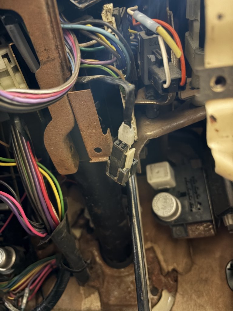

I had my arm up underneath the dash on my 87 and a wire got pulled out from somewhere and I can’t figure out where it goes. It’s a pink wire with a little black stripe. After some more looking it goes in this small plug then goes up into the steering column

Well, what doesn't work now that did before?
Wherever you pulled it out of, a janky repair had let go. So when you do find were it goes, plan on making a proper repair.

Prolly radio wire pushed into the fuse box.

no, I found where the other end goes, and that plugs in just underneath the steering column, and then goes into a flat wire that runs up into the steering column
